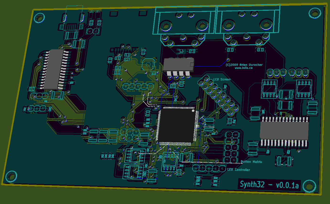

I have been working on a development board for the last few months on and off which will use a pic32 as the core, integrates a 32bit dac and has headers for LCD, 64button matrix ( Monome / Tenorion ), one general I/O, microSD slot, Midi In/Out, and USB. It will include off board RAM and EEPROM. The project is almost ready for prototype.
Inventor and I were talking in the chat and he mentioned that the eChuck forum might be the right place to post this. I have been thinking of integrating a DSP into the board as well. Although I have not decided on which one at this time, I am open to dsPic, Analog Devices ADSP, or others. I would like to know what everyone thinks would be the most convenient, and flexible. Think dream Synth / Virtual Modular.
Here is an image of the board thus far its just a 3D mock-up, but I have a lot of room to work with. Unfortunately I don't believe I can make the board the same size as the existing eChuck board, due to the USB, microSD, and Midi Headers. But let me know what you think.
So would the community be interested in something like this and secondly do you have any questions, desires, or concerns?

I just got done talking with dio in chat. We talked shop and exchanged ideas about stuff. I was very impressed with dio's skill set: circuit board design, programming, digital design, etc. We even coded up a Boolean Sequencer in G2 demo and it made some good music before dio went to bed.
I feel that this digital synth board really adds a lot to the eChucK lineup and will evolve into one heck of a good product in time. Let's all welcome dio into the eChucK fold and take a look at his design.

As to the DSP, I have only one comment: since the board has a PIC already, it may make sense to use a dsPIC. That way developers would have only a single development environment to work within when developing code for this board. Just my two cents.

Agreed, although many people complain about the dsPic only having a 10-bit D/A. I know Microchip has just released a library for the PIC32 which will allow some DSP functions. Incorporating the 32 bit DAC chip outside the PIC 32 could be all we need. The other issue is the cost of development tools. I really am interested in some of what Analog Devices is Saying about the ADSP. But, the cost for Visual DSP++ is expensive, almost too expensive for the hobbyist. Now the development tools for Pic 32 are not free if you want unlimited code size up to 512k, but you do get 64k for free with the C32 compiler.

The idea right now is to keep the hardware closed but the software/firmware development open. As this is a board that I am designing for my own personal DSP and synthesis explorations as my codebase grows so will the communities.
The key focus is keeping the development board low cost say around $100-150 but the more I put on this board the higher the price gets.. So keeping an FPGA off the board might be the way to go right now. But the PIC32 and the DAC is a must. Additionally with the new PIC32 DSP library this project is really looking promising.
Some people might be questioning my use of an FTDI USB 232 conversion chip. Well its simple I don't have to write a driver for MAC, so more systems are supported. Although MPLAB is not MAC vBox or any virtualization technology will allow for development, and Linux is included within the vBox fold.

All of you are giving me great feedback.

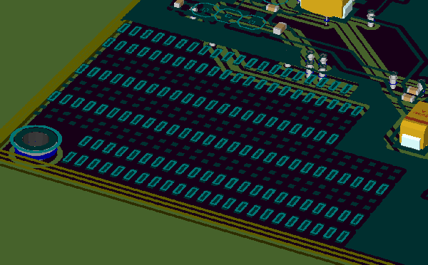

Currently the board has I/O headers which could be multiplexed to increase input control. I have designed some input controllers for other projects which I could incorporate as add-on's to the system.
Much like the eChuck concept the system would remain modular. As the project expands I feel like the ease of programming the system would improve. There are still many things that need to be done before it becomes a simple thing for many. If you are interested in a simple DIY, build your own hardware synth, you might wish to check out the midiBox project, or the x0xb0x at lady ada's. They both have some really interesting stuff.
I don't really need the sparkfun board as I own all the developing tools such as a PIC32 starters kit and the PICkit 2 programmer. I'm just looking at getting my first set of prototype boards. The UBW board is still lacking in all the additional components which this board will have, which is why this board will be more of a dedicated hardware synthesizer.
I agree that wavetables are a must, and with the integrated microSD card we could really put as many on there as we need.
But before getting ahead of ourselves lets just step back and look at my intentions of the project and see if they are inline with what your needs are.
I intended on making a development platform. As in something that can be expanded, programmed, and used as the user wishes. This is not to say there will not be basic a software framework to work within. I will need to program the unit for several things including Midi I/O, output to the DAC, interface for the microSD card. Much of this might be available already but with most open source software it can not be sold with the board. So I will be writing my own. If the user is more comfortable using existing C, C++, ASM libraries then even better.
To provide the community with a method of turning there Chuck, Csound, PD, MAX or other files into a hardware platform. This is commonly referred to as DSP / synthesis. With the new addition of the DSP library for PIC32 this has been dramatically simplified. Synthesis design is not easy but as I have found learning and experimentation can be fun and rewarding. However there is a lack of inexpensive development tools suited for the task.
Minimize cost. This is very important and the main reason for using surface mount parts. It was never the intention to have the user build the board, these boards will be assembled, much like the boards you can buy from chip manufacturers or sparkfun. The first prototype boards I will be putting together myself, but if the interest grows I will have them manufactured / assembled at a board house.
Currently I have decided to leave power components off the main board. One reason is cost, the second is if you are anything like myself you own 100 walwart's, from every electronic relic you own, or have a bench-top power supply. If not there is already a power board designed with +5v and +3v which I have ready for the main production board. However, because the unit is just in the prototype stage this is not the primary concern. The initial development will require some hardware debugging, before we can actualize the production model.
And lastly to provide an easy starter board for students to get into embedded development with audio; without needing to switch focus away from software synthesis and focus on electronics engineering / board design.
So that is really where my rationalizing started and ends.
( Update: Board size reduced slightly.. about 1 inch per side. )

I intended on making a development platform. As in something that can be expanded, programmed, and used as the user wishes....
Cool. Be sure to make good use of the unused portions of the board. If possible have extra holes for headers, IC sockets or other additional hardware. Also some extra holes to mount smaller add-on boards on spacers might come in handy.
Ermm... how about selling just the board, and pre programming it with open source software "as a free service" ? I suppose you best ask your sources if that would be ok.

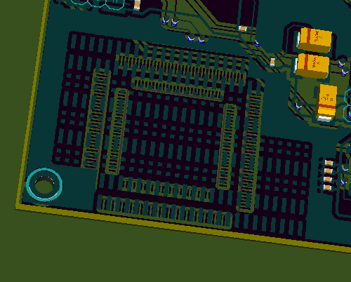

I agree. I have been considering using the portion on the lower left part of the board as a prototype area. I am glad someone has mentioned this. The next question would be is there a need for through hole or SMD or both? The upper right portion of the board has some free space as well and would make for a good prototype area. Additionally the board is a 4 layer board I could connect the pins in a matrix if desired. This would be something new but I remember a strong disliking for green wiring parts together. So the question is what are everyone's thoughts on this? What prototype setup would you like most? Euro Card, Through Hole, SMD array (which would make for 4 SMD spots for prototyping {this is the one I am interested in the most}), or other?
I would definitely be willing to load the boards with software, as a free additional service. My only concern regarding this is the limits of licensing, as I do not want to overstep the bounds of GNU, GLP, etc.
My own personal framework will probably be available as Creative Commons - Attribution, Non-commercial licensing. However, I need the boards to start testing this code-base.
As for just selling the boards I would be interested in doing that as-well. The parts count is not overly excessive, and I like the idea of anyone building their own if they are capable. The project uses SMD and as such sometimes people find it hard to work with them. although I have deliberately used part sizes no smaller than 0603, which is the smallest I can personally work with with out going completely mad using my iron.
The next step is the number of boards I am going to order. I just received a response from a board house with a reasonable pricing for 4 layer, however, I am going to wait for a few other quotes. I have been making some minor adjustments and checking the continuity of some areas ensuring a minimum of problems arise when work begins. There are bound to be a few issues that I am just not seeing at this time.
electri-fire thank you for the suggestions. Everyone has been very helpful and the input is going to help create an excellent development board.

Pad Array.
So I have spent the better part of an hour adding this pad array. Once I decided on a suitable layout I needed to move some traces. Let me know what you think about this?
Possible Pad Array for Development board.

Here is the update. The board now has pin access to all the remaining I/O through SMD pads adjacent to the pins on the chip. The new prototype grid has been expanded to both sides of the board and the over all board size has dropped by .1"
I have been talking with some board houses and on the suggestion of Inventor I will be using a company in Arizona. I am about 98% satisfied with the current layout. But there may be changes or revisions once I start working with it. If you would like to be included in the prototype board run let me know. The run will be very limited but I would like to see at least 2 other people involved in the debugging process.
New Prototype SMD grid with TQFP pads on revers side for TQFP100 and TQFP144.
