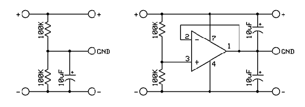

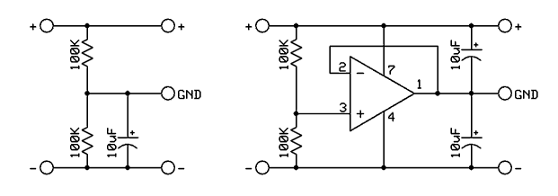

PostPosted: Tue Apr 20, 2010 11:18 am    Post subject: creating virtual GND Reply with quote  Mark this post and the followings unread
Here are 2 methods I use. Usually the first one will suffice, but If I have a circuit with a couple of opamps that need GND, I go for the second one which is more stable.
virtual GND from single power supply
 Filesize:  4.79 KB
 Viewed:  177 Time(s)

PostPosted: Thu Apr 22, 2010 1:49 am    Post subject: Reply with quote  Mark this post and the followings unread
Using a spare opamp to do it the second way is good. But really needs 9V or 12V or more for most opamps. On 6V you are only getting +/-3V and TL07x opamps can't do input/output voltages that are anywhere close to the rail voltages. They like to stay at least 2 or 3 volts away from both rails. Which means on +/-3V you can really only handle signals of a few millivolts before things start to deteriorate.
There are some opamps designed for low voltage operation that can handle signals close to their rail voltages. Better to use one of them.
