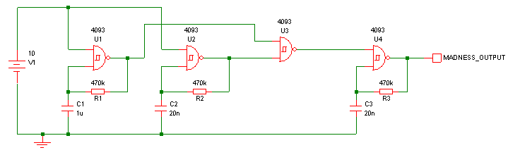

Here is my first foray into Lunetta/CMOS/Logicotronic sound making devices!
http://www.youtube.com/watch?v=1MU16cC06aM
I name it bleeping ear masher.
http://www.youtube.com/watch?v=RsGaSlGtGXU
Schematics are included below.
I used just one 4093 chip (four NAND gates with built in schmitt trigers on the inputs)
The three 470k resistors in the diagram were variable, and one might have been a 1 meg pot, I didn't check because I was sure it was either 1 meg or 470k. Each was in series with a 10k resistor (or there abouts, I think one was 15k).
The two oscillators on the left are low and high frequency, thier outputs are combined by the third nand gate which then gates the final oscillator.
All component values are variable however very low values for the resistors results in high distortion of the output and subsequently significantly less fun Sad keep them above 10k to maintain spiffing sound madness! Very Happy

A question just occured to me, how would one combine the outputs of two gates? via diodes?

Sorry, didn't see your question, yes with two diodes, that forms an OR gate.
you can see various ways of simple gates w/ resistors or diodes on the image, the double inverters are to buffer the gates, but when your sending it into another CMOS chip, you will not need them

Brilliant, thankyou! That is exactly what I needed Very Happy
