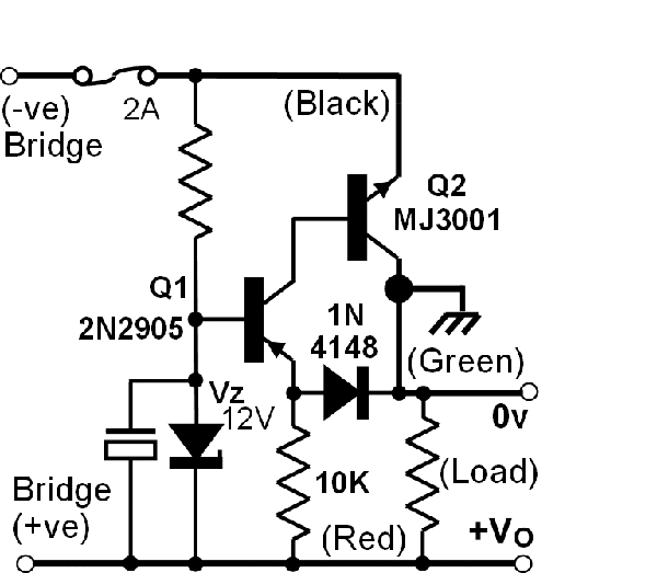

OK, just for grins, here's a power supply design that is used in the MB-808. Hopefully we can use it for a good example of some of the trade-offs that are made in power supply design.
This design uses the very common 7805 +5V regulator, the 7815 +15V regulator and the 7915 -15V regulator.

In the above supply, what exactly do D35/D36 (D39) and D37/D38 perform in the circuit?

PostPosted: Wed Jan 18, 2012 2:44 pm    Post subject: Reply with quote  Mark this post and the followings unread
Those are the paranoia diodes...

HA, I should have the the CGS14 doc more clearly. There are two Diodes "PER REGULATOR!" Embarassed
Also as Blue Hell asked, what's D41 for?

Sorry, I was going to post more before now, but I had a department meeting to go to. Day jobs, heh... Rolling Eyes
Anyway, yes, those two diodes are about protecting the regulator output. As I said, "paranoia" diodes, you can take that two ways, 1) if you're paranoid that you'll damage something it's a good idea to put them in, but 2) if you're paranoid enough to make sure that everything is exactly perfect, you won't need them... Laughing
D41 is a simple one, without it, the 5V section is separate and needs its own transformer, and with it, the 5V section takes its input from the same place as the +15V. I could have used a jumper, but I'm a bit paranoid... Wink I had some transformers made up that have three secondary windings, two for 15V and one for 5V, so I leave that one out of my builds. For extra points, what about C21 and C26? Are they necessary if D41 is in place?
While I'm at it, C211 through C237 are distributed across the MB-808 PCB. (There are eleven separate voice sections.)

Could you clarify DGND a bit too? People will break their heads over that one once they built I guess ... as it goes "nowhere" now.
In this particular design, everything is included on a single board, so DGND (digital ground) and PE (analog ground) are planes that are poured copper on the PCB. L1 is a ferrite bead that connects the two. The two and three pin output headers are optional...

Dougster wrote:
Looks like we're going to reach critical mass for power supply discussions here on E-M...
I had thought that this tip comes a few decades too late, as virtually nobody seems to build their own analogue supplies these days..
In an era when packets of peanuts are emblazoned with the statutory Health and Safety banner: "Warning: contains nuts", old-timers sometimes forget that some people have not yet learnt that electricity is dangerous. An earthed metal case for a power supply not only reduces the fire risk and protects you from exploding capacitors (!), but also cuts-down on hum pickup in amplifiers, shields fingers from lethal voltages and guards against the line/mains wire coming loose. When constructing the PSU, an earthed metal plate (perhaps the heat-sink for the bridge rectifiers) can be situated to shield the "hot" side of the transformer. A rubber grommet in the metal case protects the input supply lead and fitting a tie-wrap or simply tying a knot in the cable protects against bare wires being jerked free.
The end result can be much safer than cheap imported light-weight supplies in plastic boxes which radiate and in which the critical capacitor can break down and the box melt. Now we've got the legal stuff out of the way, let's get to the point...
Conventionally, one output of the bridge rectifier is grounded, or in a dual ± supply the centre-tap of a 12-0-12 transformer is grounded. For a heavy-duty supply requiring heat-sinks, this requires insulating the regulator/output transistor from the grounded heatsink (messy and awkward), else risking sparks flying by having the heat-sink at the full "raw" rectified voltage.
If you choose a transformer with separate 0-12V, 0-12V outputs, you are free to re-locate the ground. In the attached diagram, the output power transistor is mounted directly on a grounded heat-sink and the "regulated output" comes straight from the bridge rectifier!
The diode completes a "poor-man's long-tailed pair" with the advantage that it can tolerate a large reverse-voltage. If an accidental output load is your screwdriver to ground, the diode cuts-off and current is limited to the current through the emitter resistor, multiplied by the gain of transistor Q2. This protects the components until the fuse blows.
The MJ3001 is a power Darlington, with built-in base-emitter resistor. Its TO3-style metal case is connected to the collector.
Simple current-limited regulator "turns things upside-down"
 Filesize:  23.43 KB
 Viewed:  390 Time(s)
