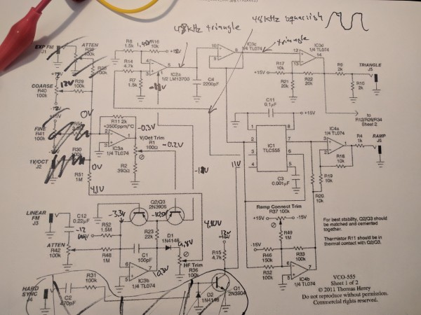

Hi all,
I've been lurking as this forum as a reader for a while and just started breadboarding this vco as my first project. Thanks for all the great resources!
So after a few initial mistakes (I fried a 555 and the 13700 got pretty hot too but seemed to survive) I can at least see some oscillation on my oscilloscope. I don't actually have any amp or anything where I'm at, so I'm stuck with a cheap 18$ oscilloscope or my earplugs (fried one of those too with 24Vpp Smile
So, I have oscillation around 1.25KHz from 555:s output, but I think I have problems with my exp converter. Turning any pots doesn't make the slightest difference. I have removed some stuff to simplify while breadboarding and maybe I have errored here.
I have pin 2 on IC3 being seemingly grounded. Trying to understand the schematic that would be the summed up linear CV I would guess, so having this being close to ground whichever way I turn the Coarse knob makes me pretty suspicious.
Even if I turn the Coarse knob all the way to 12V I have a voltage drop over R29 from those 12V down to ground. I don't seem to understand how this can be though…
I've tried rebuilding just the cv converter separately to see if I can isolate but it would be so super nice if there where any reference voltages or something that I could check against. I get the same grounded pin 2 on IC3 there (the lowest breadboard)

Slept on it, but I'm still super stuck.
Is there anything that seems suspicious with any of my measure points here?

pin 2 on IC 3a may be considered as a "virtual earth summing point" of the inverting amp built with it (http://www.electronics-tutorials.ws/opamp/opamp_2.html)
so that being (around) 0V should be OK.
That being said, I am surprised by the -3.3 V at the pin 6, since IC 3b is also an inverting amp
hedefalk
Joined: Aug 29, 2017
Posts: 38
Location: Stockholm, Sweden
PostPosted: Wed Aug 30, 2017 4:28 am    Post subject: Reply with quote  Mark this post and the followings unread
Yes, I realised this later on that pin 2 on IC 3A would be pushed towards ground by the feedback resistor, was a bit tired there after troubleshooting several hours and I'm just learning about all this Smile
By twisting the Coarse pot I can get from -0.3V to +0.25V on IC3A output pin 1.
IC3B pin 6 is actually around -3.8V now (I've twisted pots and exchanged the 3906:s so maybe because of that)
Could you elaborate on that? I'm still trying to understand how this circuit should work Smile
There's around 10V on the output from that opamp, but there's a cap going from the output to the inverting input so no DC coming through there.

PostPosted: Wed Aug 30, 2017 6:18 am    Post subject: Reply with quote  Mark this post and the followings unread
Ngh!
After doing more and more troubleshooting and exchanging components to see if anything was borked, I now have something entirely different and no oscillation from the 555 at all:

gdavis
Joined: Feb 27, 2013
Posts: 359
Location: San Diego
PostPosted: Wed Aug 30, 2017 8:34 pm    Post subject: Reply with quote  Mark this post and the followings unread
hedefalk wrote:
Ngh!
Check IC3 and it's connections. Pins 8, 9 and 10 should all be the same voltage.
Posts: 3918
PostPosted: Thu Aug 31, 2017 12:39 am    Post subject: Reply with quote  Mark this post and the followings unread
as i see it this is a clever approach of the classic integrator(IC2A)/comparator(IC3C) VCO with C4 being the timing cap, only that the switching is done by the 555 (ISO a JFET).
BTW how did you measure the voltages? It would not make much sense to measure the voltage with a DMM at pins IC3C/p8&9 and IC1/p2&6 since this is where the actual core oscillation happens. Or do you have a scope for the measurements?

hedefalk
Posts: 38
PostPosted: Thu Aug 31, 2017 2:25 am    Post subject: Reply with quote  Mark this post and the followings unread
They are not. non-inverting input (pin 10 is negative close to ground, -0.2V and and 8, 9 (output and inverting input) are saturated pos on around +10.3V it seems. Why should they be the same? There's no feedback resistor?
This circuit is really hard to understand for me, I guess it was probably not the best thing to start with as a newb Smile

PostPosted: Thu Aug 31, 2017 2:33 am    Post subject: Reply with quote  Mark this post and the followings unread
fonik wrote:
I'm using this cheap ebay 18$ digital scope. I actually bricked my multimeter so I'm only using that scope to measure everything.
I HAD oscillation at one point on these pins but at 47kHz (could this be what a saturated +12V CV would give?) but at this point I have no oscillation, but around +10V constant.
Posts: 3918
PostPosted: Thu Aug 31, 2017 3:12 am    Post subject: Reply with quote  Mark this post and the followings unread
are you powering this circuit from 12V or from 15V?
measuring the voltage on the control pin of the OTA is not that simple. this input is a current input. it normally sits on the negative supply and should go up just a little bit when you feed this circuit a CV.
anyways, maybe you should start from scratch with just the OTA, IC3C and the 555.
leave off the expo for a start, just connect a 100k pot (between +V and -V)with wiper via 56k to the OTAs control input.

PostPosted: Thu Aug 31, 2017 3:19 am    Post subject: Reply with quote  Mark this post and the followings unread
I'm using 12V (eurorack)
Thanks, I'll try that! Sorry if stupid question, but that's the amp bias input you mean on the OTA? Pin 1?
Posts: 3918
PostPosted: Thu Aug 31, 2017 3:27 am    Post subject: Reply with quote  Mark this post and the followings unread
yes, pin1.
and if you measured -12V on the OTAs pin1 then this is the negative supply. i think it is a safe bet that you either got no control voltage/current to this pin (see my post above), or that your OTA is fried.
pin1 (pin 16 resp) sitting on the negative supply no matter what you do is a safe sign for a dead LM13700.

hedefalk
Posts: 38
PostPosted: Thu Aug 31, 2017 3:59 am    Post subject: Reply with quote  Mark this post and the followings unread
I'm more and more expecting these cheap Chinese breadboards I'm using…
And yes the OTAs pin 1 stays at -12V no matter what. I'm into my third LM13700, I'll try one more (only have 5) before I rebuild from scratch. Not good if my current setup is instantly frying those chips Smile
I did what you suggested with the current one though. I have triangle oscillation in OTA pin 5. YEY! And I can control the frequency with the 100k pot. I'll probably just sit here and twist that knob all day - this is the first time I've heard anything, been just watching that scope for a few days Smile
Still, the OTA pin1 is constant -12V. So the voltage drop over the 56k resistor is the whole diff between anything I turn the pot voltage divider to. Anything from -12 to +12 and the other side of the resistor is still -12K. You sure about the OTA being dead then?
By the way, when I probe pin 1 with the scope, the tone rises a couple of octaves - I guess the scopes impedance isn't very high? Or is this just the case since this is a current input?

and thanks foe explaining the topology of the VCO.
so the core can be narrowed down to the mere 13700, 555 and IC 3 c ?
how do i go if i want to leave out the hard sync ? leave the 555 pin 4 unconnected ? Smile
now this is a starting point, isn't it?
so you just have to re-build the expo section now. make sure that you have the transistors in the correct pinout and orientation. if you are in doubt refer to the datasheet, or take a look here:
the 56k converts the voltage to a current that is suitable for the OTA (Ohm's Law). remember, the OTAs bias input works with current, not with voltage.
IIRC one expects just a tiny change in the mV range. maybe you simply cannot see it on the scope with the current setting.
do as hedefalk did, use the 4k7 (R15) pull-up resistor.

alanwilder81 wrote:
thanks Mattias,
I can hear my VCO oscillating and sounds awesome.
The waves look perfect on the scope.
i am trying to find a way to measure their amplitude.
and trying to understand why, when sweeping the coarse tune knob, my regular DMM reads a voltage fluctuation, while the oscilloscope shows a perfectly consistent amplitude Very Happy
so , i believe DMM is not right to measure AC ?
cheers
a DMM has a ~V function, however, it does not help, when you even don't know if it oscillates at all.
i use my scope to measure the amplitude. for our simple synth DIY tasks a cheap USB scope is enough, i believe.
