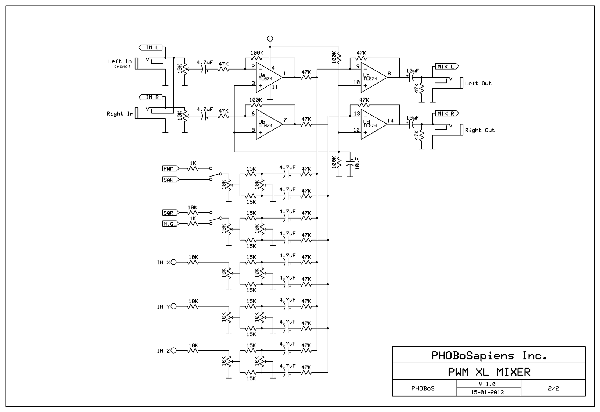

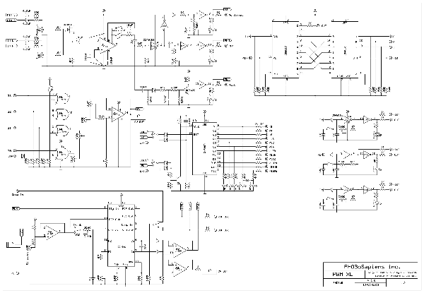

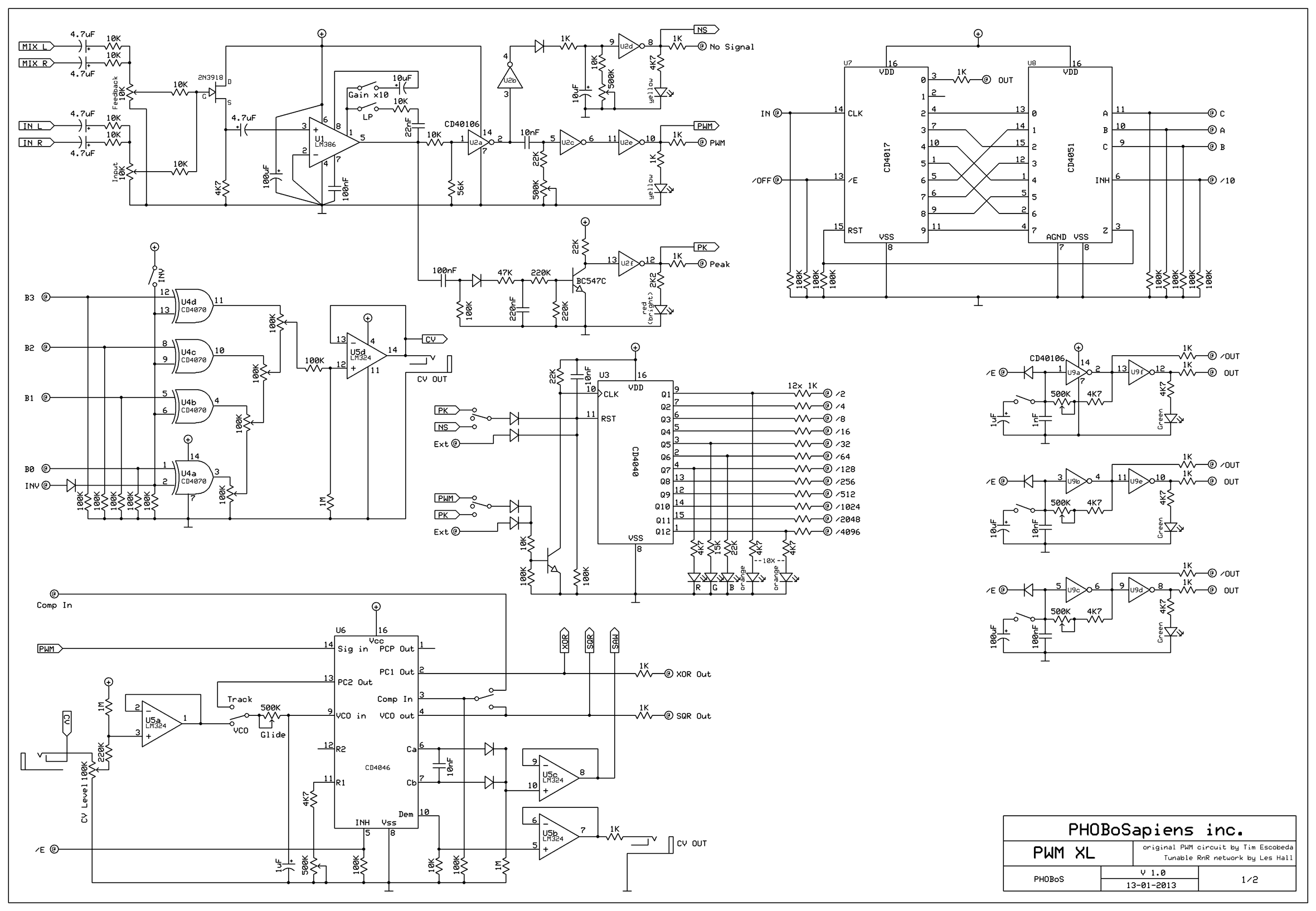

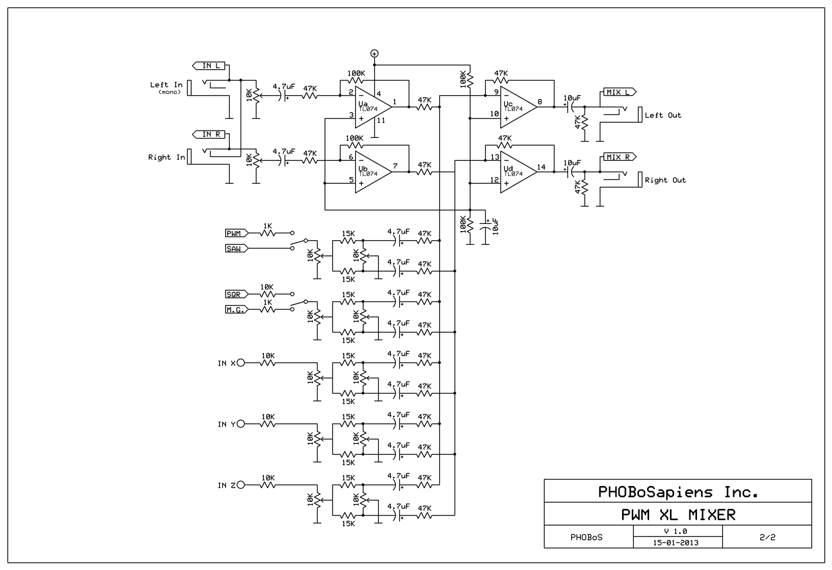

This project started out with a modified version of Tim Escobedo's PWM circuit. I had allready added a 4040 divider to it and
to make some more use of it as a standalone instrument I decided to add a VCO and R2R. But instead of a standard R2R, I used
inventor's tunable rnr network. I added some XOR's on the inputs as buffers which can also invert the signal.
After I heard jcintheus' excellent 21st Century Schiziod Mess I decided to put in a 4051/4017 melody generator* aswell. And to
be able to make some more use of it I also added 3 oscillators made with a 40106.
And to top it all of I put in a stereo mixer with 2 channels that have dedicated inputs that can be selected with a switch,
and 3 'free' channels. All 5 channels have level and panning control. The original PWM input signal can also be mixed in and
there is a feedback loop from the output of the mixer back to the input of the PWM circuit. I used a simple FET mixer to add both
signals to that circuit.
more pics here
*the 404/4051 is wired up differently for easier PCB wiring, but it works just the same.
PWM XL schematic page 2 (mixer)
 Filesize:  47.29 KB
 Viewed:  1195 Time(s)
PWMXL Front design
 Filesize:  751.84 KB
 Viewed:  893 Time(s)
PWM XL schematic page 1 (lunetta circuits)
 Filesize:  144.61 KB
 Viewed:  1212 Time(s)
