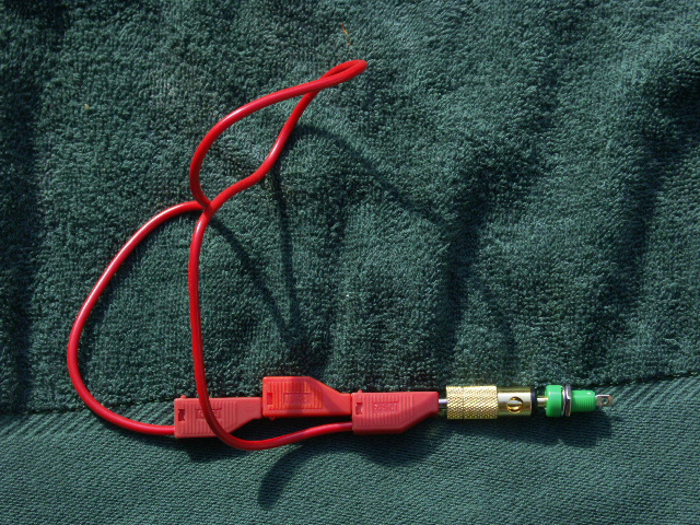

v-un-v
Joined: May 16, 2005
Posts: 8932
PostPosted: Wed Jun 22, 2005 9:36 am    Post subject: Reply with quote  Mark this post and the followings unread
Hey Zebra,
I'm going banana(s) too. Went and got a couple from Maplin this morning (Blighty's version of Radio Shack). Forget jacks, bananas are definately the way forward imo.
I guess I'm lucky. I can visualise easily in 3-D. But heres a pickie to help you understand.
Tom

Wild Zebra
Joined: Apr 28, 2005
Posts: 806
Location: Ohio
PostPosted: Wed Jun 22, 2005 9:49 am    Post subject: Reply with quote  Mark this post and the followings unread
Well to late I already got jacks. I got switching jacks so when its not patched I can use it like its normalized. As to my ? I been studying this schematic for about 2hrs and I think I'm starting to get the picture.
I guess thats what they call stackable banana jacks ?
So how close are you? I'm hoping tonight I may have everything wired and get some sound. Ran out of solder and need 2x2uf caps. Can't find any though figure I'll twist some 1uf's together
then onto the case. I can't wait to see a pick of that clear case Soundlab
