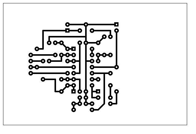

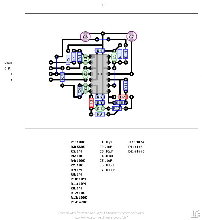

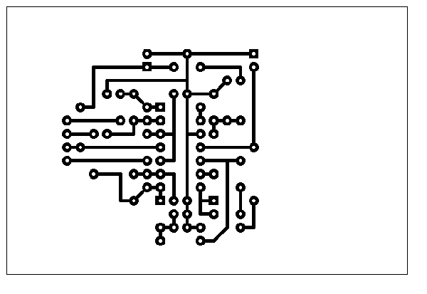

PostPosted: Sat Oct 23, 2010 5:43 pm    Post subject: Reply with quote  Mark this post and the followings unread
hey guys, i thought some people might like a PCB of the guitar trigger, so here's the one i put together. Hasn't been hooked up to the soundlab yet, so give it a run through against the schem, but i checked it a few times and it looks good to me. Hope this helps someone!
 Filesize:  15 KB
 Viewed:  988 Time(s)
 Filesize:  5.23 KB
 Viewed:  954 Time(s)

PostPosted: Mon Jan 03, 2011 7:22 am    Post subject: Reply with quote  Mark this post and the followings unread
this layout is verified FYI

Hi all, can I just check something before soldering things together;
The cathode of C4 is installed in row 3 and (via the jumper) is going to 0v. The anode of C4 is installed to row 1 and going to +9v?
And, for C3, anode is installed in row 2 and going to 0v and the cathode in row 4 and (via jumper) going to -9v?
minimofo
Joined: May 11, 2011
Posts: 7
Location: SW, UK, OK!
PostPosted: Fri May 27, 2011 9:40 am    Post subject: Reply with quote  Mark this post and the followings unread
^^ Scratch the above- realised I'd got the answers I needed via the other side illustration of your stripboard layout Uncle Krunkus Embarassed
Well, finished it off this afternoon and I couldn't be happier. Have only had 20 minutes with it due to a sore (soldering) back but it's tremendous fun. I've yet to add the input to my Mini Synth in order to hear the guitar, but checked it amplifies correctly and whatnot. The gate feature is great on it's own- not sure why d1cking about on the fretboard is so much more satisfying than the little button on the synth itself, but it is, so there you go!
Built a stripboard version of the Charge Pump in the end (in the top/left corner) and used a little socket and leads to enable me to connect and disconnect the high frequency option on the chip. Will see, when I've got the synth modded, whether the oscillation is audible.
Ran R5 out to a 10k pot with a 3.7k resistor in series (right hand pot) to give a gain adjustment of 3.7-13.7k and also ran R13 out (left hand pot) to the same arrangement in order to provide gate sensitivity adjustment.
For the overdriven/clean leads, they're going out to a switch selecting between the standard 1M resister for the former and an adjustable preset for the latter. Used a 470k preset and 370k resistor in series to adjust the clean signal level from 370-800ish k.
Well worth a build, thanks everyone for your layout, your help and thanks to Ray for sharing the idea in the first place.

PostPosted: Sat Feb 15, 2014 6:10 am    Post subject: Gate out Reply with quote  Mark this post and the followings unread
Thanks for the PCB inlifeindeath. I had one question though. Where do you take the gate for the soundlab from? I am sure I am just being a noob but I can only see the +9, -9, Ground. The clean/dist points that go to a switch and on to pin 3 of IC4 of the soundlab, and the input.
Any advice would be most appreciated
inlifeindeath
Joined: Apr 02, 2010
Posts: 316
Location: Albuquerque, NM
PostPosted: Sat Feb 15, 2014 8:59 pm    Post subject: Reply with quote  Mark this post and the followings unread
oops looks like i forgot to include a pad for that.
you can add a pad or solder to the junction of D2 and R12.
