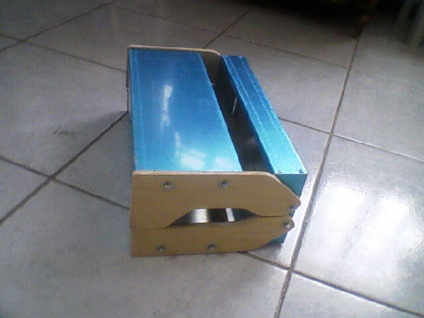

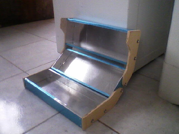

Hey guys, here's a 200e-style cabinet I just finished... I had three aluminum boxes I was going to use for desktop-mount of modules, but I changed my mind and decided to make it like a Buchla 200e cabinet, because it's portable and very... cute. I just had to make the wood ends and do some fiddling with CadSTD and Autocad to get the design right. Well, it works and looks great! Now I just have to make some holes and new panels for my old modules.
If anyones wants the CadSTD/Autocad files for the wood parts, I'll post them here (If I'm allowed to)
Hope I'm not breaking any copyright law or something. I just did it because it's a fantastic design... Smile
(Taken with my phone camera...)
 Filesize:  51.63 KB
 Viewed:  893 Time(s)
(Closed cabinet... the "blue" colour is because there's a sticker to protect the aluminum. I won't take it out until the modules are ready to preserve it)

Nope... I wish! But I have boards ready to use for the quintessential Buchla modules - AD/AR, Lopass/Gate and dual VCO. They're not exactly the same circuits (only the lopass), but I was inspired by the layout and Mr. Buchla ideas! Smile

how do you make it stand up in a curve without collapsing or being wobbley?

Well, there are two feet to hold the middle boat (not installed yet), and two "stoppers" (I don't know the exact word) to keep the two boats in place in relation to the middle. It's hard to explain, but here's a website with photos of the the Buchla cabinet that helped me a lot: http://www.synthi.se/bcab/

Hi! I got them at a metal shop near my house, where I also buy my (aluminium too) panel plates. I asked them to fold the metal sheets for me. They also sell other materials... At first I tought about doing it in steel, but I just love the look of brushed aluminium Smile

It's also worth noting that there are bolts that fit through little metal flanges, when the cabinet is unfolded. These get little knurled brass nuts screwed onto them to keep the cabinet solid. You can see the flanges and bolts in the folded-up picture that site: http://www.synthi.se/bcab/b4.jpg

GlassX, what are the x (w),y (h) and z (d) dimensions of the metal cabinets?
fwiw, originally when I saw the Buchla it took me two takes before I realised how small the thing was! Have you based the dimensions on eurorack sizes? AutoCAD is giving me a reading of 5.9056cm for the height (y) - that can't be right can it Confused I'm hoping I can scale the diagrams.

My metal boats are very small indeed! They are 40x15x5 cm. As I mentioned, I chose a new form factor using round numbers in metric format for ease of construction, so, they're not standard. The wood sides are 1cm taller than the cabinet for asthetic reasons.
The original 200e boat (the 12 modules version), OTOH, is 7"x17"x4"...
However, I believe that scaling the drawing to your favourite form factor is the best option... if you scale the wood parts to about the same size, they're gonna fold right Smile
You're not wrong there!! Laughing 5cm deep??! Shocked That doesn't leave a lot of room for component height tolerances or power distribution Confused
