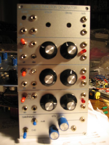

sorry yeah i added that diagram after i was asked about it early on- the middle terminal of the switch is the throw, so i guess the line should go straight through in the schematic. there was an error in the PCB for use with a 3-pos. mode switch as in the original- hence the redundant wiring. if you seperate the functions into 2 seperate inputs [trigger/gate] like i did in the new module i made, there is no error..
anyways, just follow that diagram and it should work fine. the diode [D11] is optional- it allows you to gate the FG when in cycle mode.
oh here is a new photo of the module i made pretty much done..
