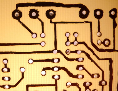

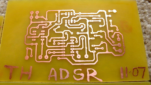

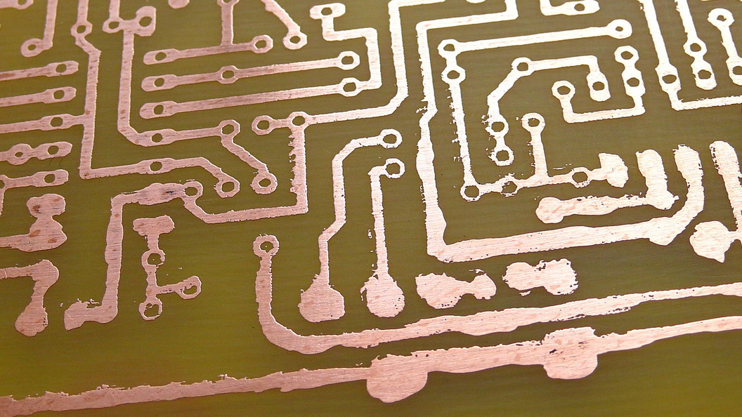

Hi folks. I have been struggling with making my own PCB's for quite a while now. It is very difficult to get consistent results. I have just about tried every technique that I have come across.
I tried printing on glossy photo paper using photo copiers, and color - black and white laser printers. I have tried printing directly onto those PCB press and peel films. Lately I have been printing onto clear laser transparencies. Using transparencies is by far the simplest technique I have tried so far.
These all work but rarely can I get excellent results. The toner rarely completely adheres to the copper. I always have to touch up the toner after I have ironed it on. I discovered that the best way to fix the design is by painting in the missing traces with black acrylic paint, using a small paint brush. Yes this is a huge pain in the arse. It never looks good but it works, as you can see from the pic's below. After the board is etched, the traces usually have little holes. I try to fix that by running the iron over them and filling them up with solder. It would be nice if the tiny holes weren't there in the first place. Oh how about getting the PCB design to be correctly sized before printing? That is one of the biggest problems I always encounter.
The only technique that I haven't tried is using pre sensitized copper boards and the UV light. I have avoided this technique, basically because its very expensive. How do you guys do your own PCB's? I see all these great DIY PCB's out there and it leaves me wondering what I'm missing?
Thanks,
pete
This one came out good, though I still had to touch it up before etching.

Here is an example of the tiny holes in the traces.
 Filesize:  59.79 KB
 Viewed:  32687 Time(s)

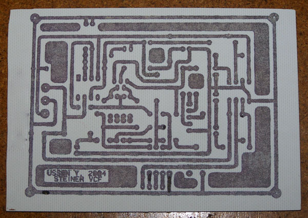

some examples:
 Filesize:  73.81 KB
 Viewed:  32663 Time(s)
 Filesize:  45.49 KB

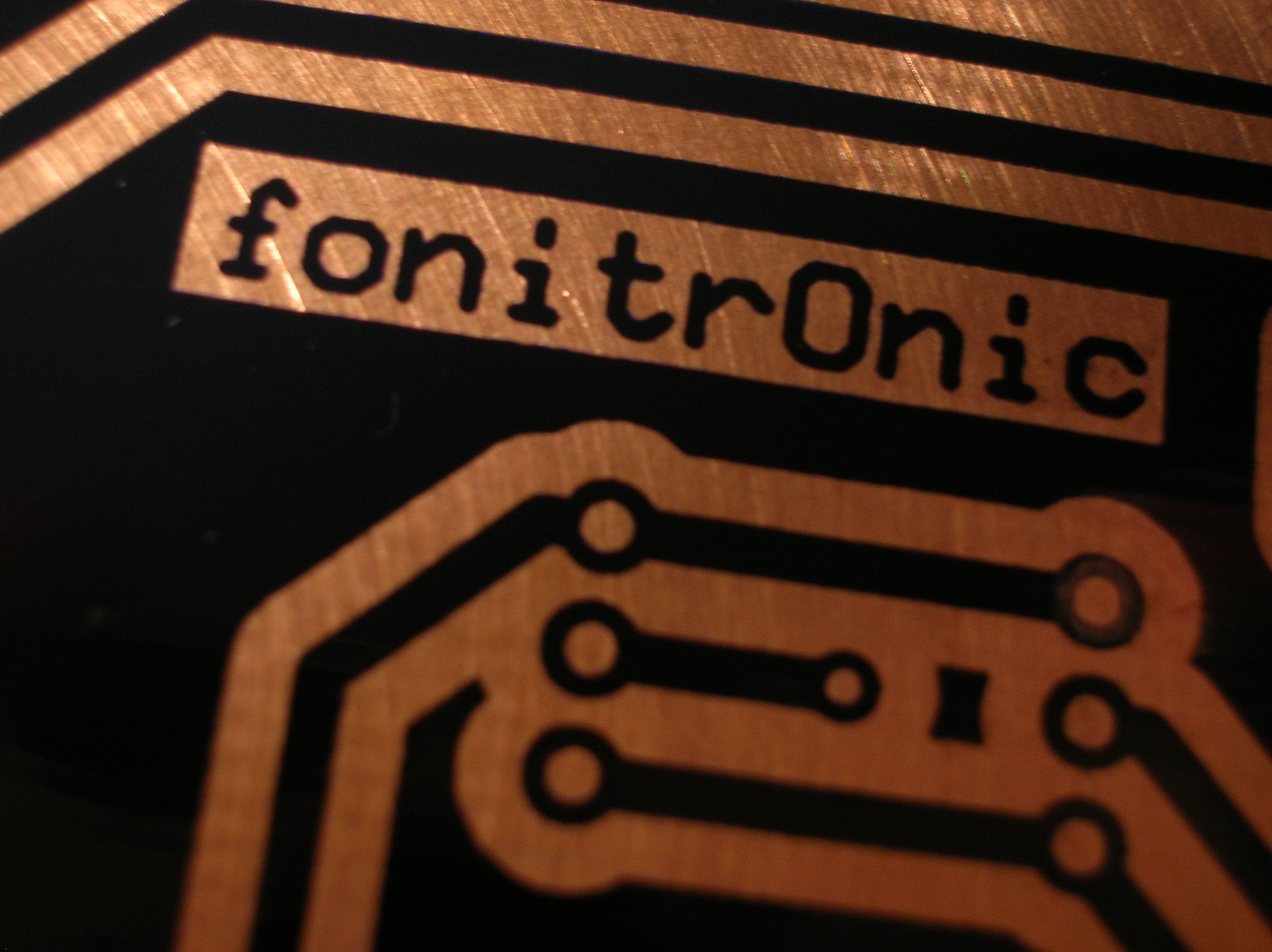

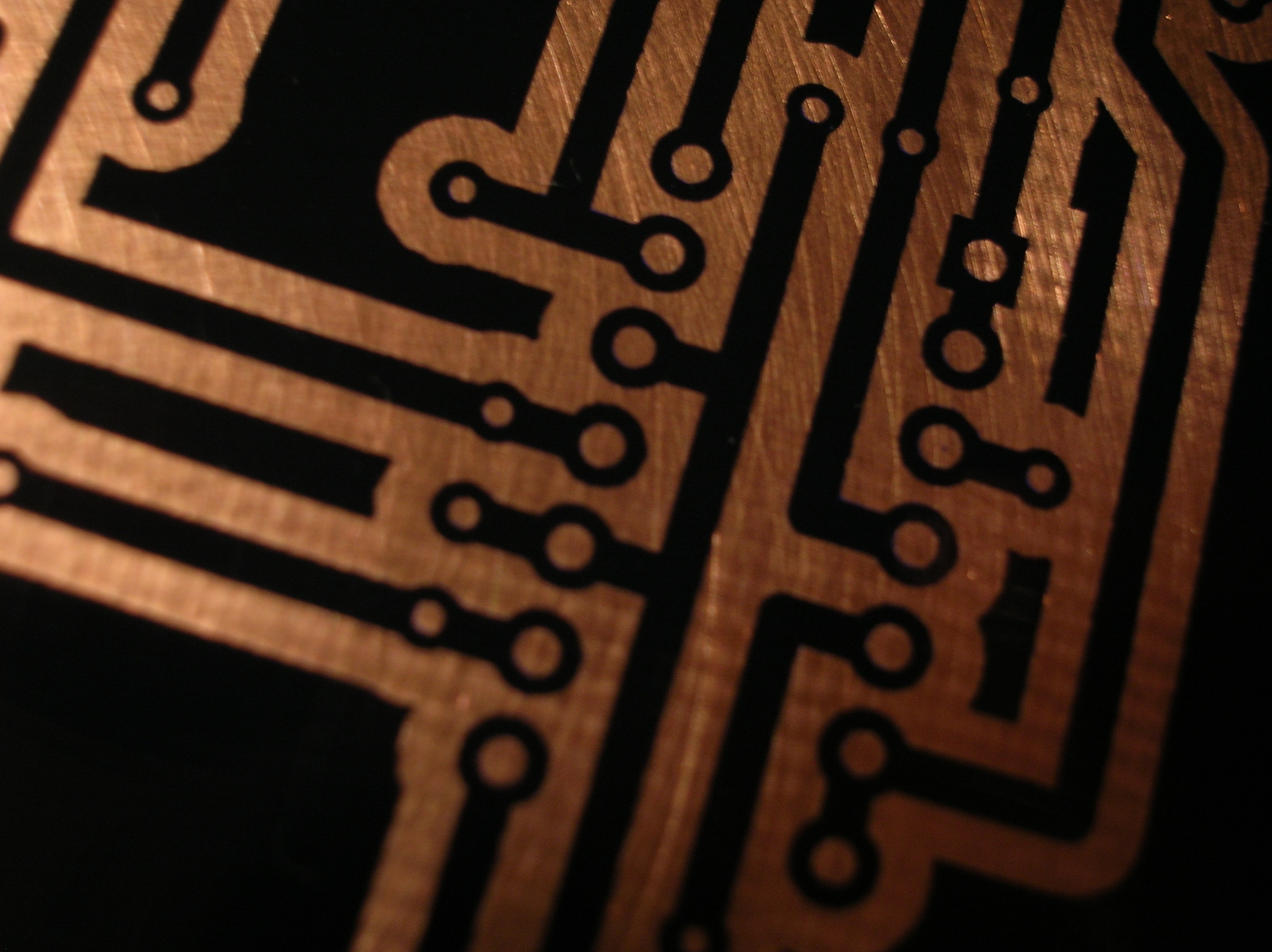

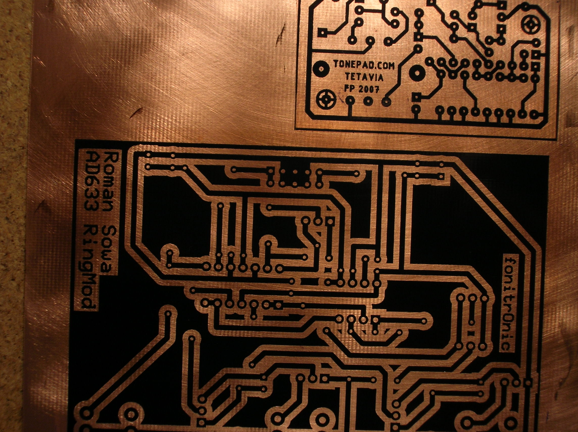

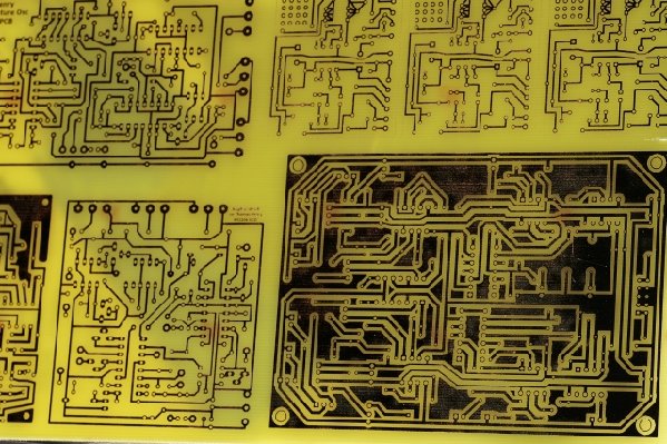

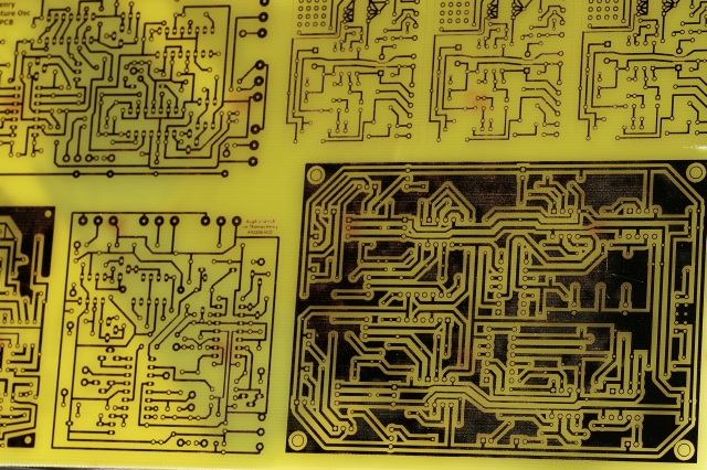

PostPosted: Fri Nov 09, 2007 11:03 am    Post subject: Reply with quote  Mark this post and the followings unread
just wanted to add some pics from the PCBs i am going to etch tonight. made using press'n'peel blue (PCB for Roman Sowa's AD633 rinmod and a tonepad PCB for an octaver i'm gonna build for my wife as an christmas present!). you can see how sharp the edges are. traces could be much much thinner...
