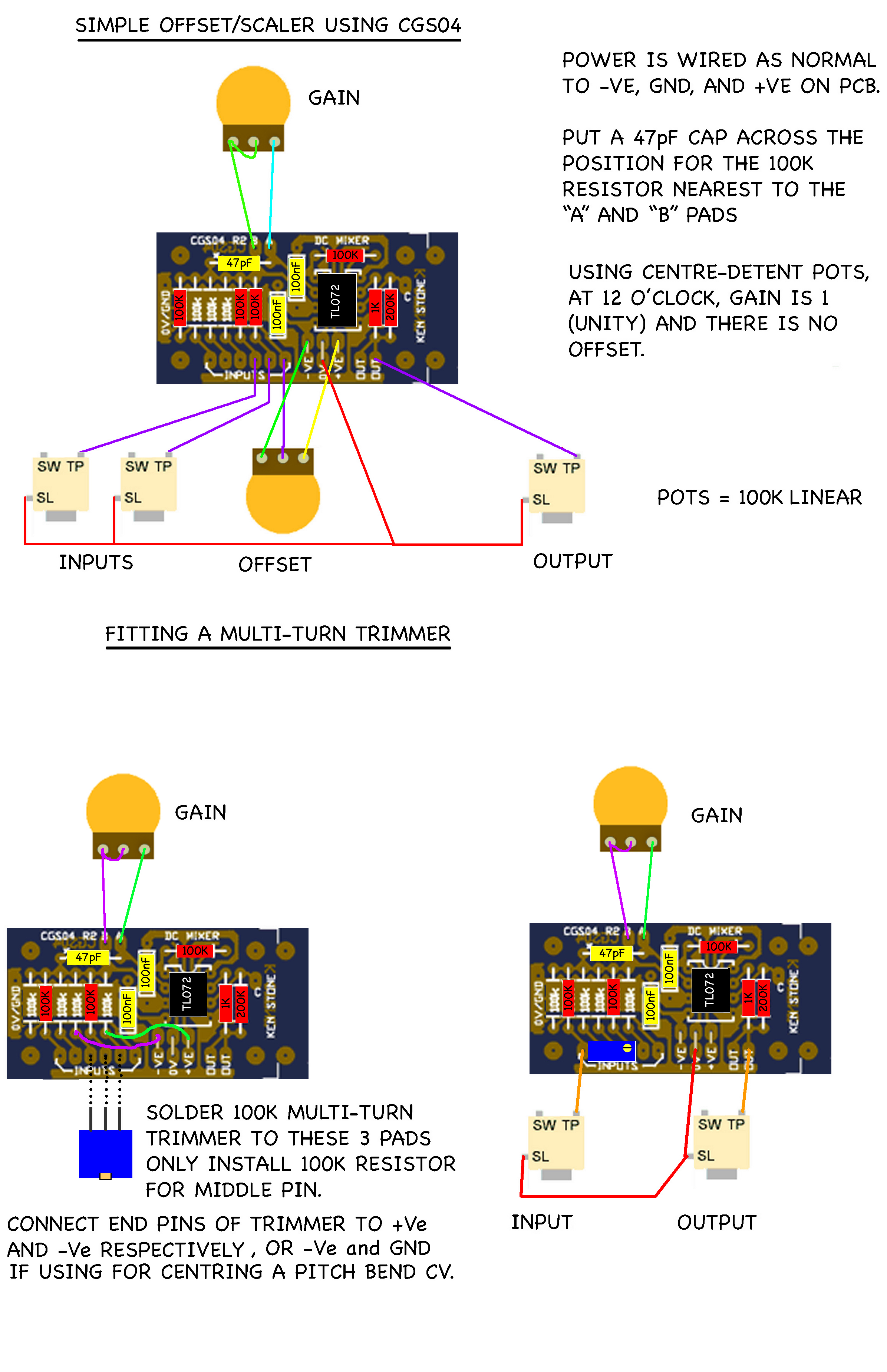

Here's a dead-simple circuit I use all the time when tweaking circuits, and it is a useful module in its own right.
If built with both OFFSET and GAIN as centre detent pots, with both pots at 12 o'clock, there is no gain or offset - the signal, CV or audio goes straight through unchanged. The max gain with this circuit is 2X. It could easily be made more, by increasing the 200K resistor, but the pot would no longer be at unity gain at 12 o'clock.
The second pic shows how to convert Ken Stone's CGS04 mixer PCB, for those who don't like perfboard.
The trimmer version is useful for turning a 0V, +5V, +10V PITCH BEND CV from a midi to CV converter into a -5V, 0V, +5V output. (i.e. centred)
If using it for this, connecting the outer pins of the OFFSET trimmer to -Ve and GND gives more control range from the trimmer (because it needs to go negative anyway, so the trimmer only covers a span of 15V, rather than 30V.
If you're really enthusiastic, you could try wiring a resistor in series with each outer pin going to-Ve and GND, and use a smaller value trimmer. This would give even finer control.
Hope this is as useful to people as it has been for me. Smile

No 2nd pic?

Dave Kendall
Joined: May 26, 2007
Posts: 421
PostPosted: Mon Jun 08, 2009 11:15 pm    Post subject: Reply with quote  Mark this post and the followings unread
Embarassed
here it is...
(edited to actually include the pic Smile )
