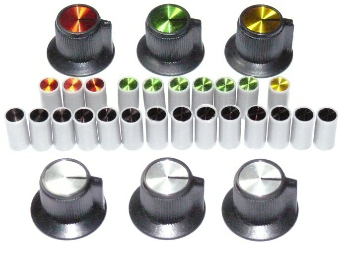

TekniK
Joined: Aug 10, 2008
Posts: 1059
PostPosted: Mon Sep 07, 2009 1:41 am    Post subject: Re: Resonator Section of Polymoog ...
Subject description: Panel design
jhaible wrote:
I think these Moog slider knobs look beautiful, too! Hard to get something similar today, I guess?
technologytransplant sell those slidercaps on ebay,the where also used on the moog opus3 synth
Individulal outputs are indeed useless imo on this one.

TekniK wrote:
http://cgi.ebay.com/ws/eBayISAPI.dll?ViewItem&item=290272133893&ru=http%3A%2F%2Fshop.ebay.com%3A80%2F%3F_from%3DR40%26_trksid%3Dp3907.m38.l1313%26_nkw%3D290272133893%26_sacat%3DSee-All-Categories%26_fvi%3D1&_rdc=1
TekniK
Posts: 1059
PostPosted: Mon Sep 07, 2009 9:14 pm    Post subject: Re: Resonator Section of Polymoog ...
jhaible wrote:
Interesting!
Thanks for the pointer - seems to be a good source for replacement parts!
But there are no sliders to match, are there?
I mean, would these knobs fit on any Alps or Bourns or whatever sliders are currently available?
i Have no idea Juergen,u will need to buy a sample to test that.
Btw u don't need to buy the offered kit,u can mail the guy asking for specific part and buy them off-ebay
KEYKEYEYEKIT
