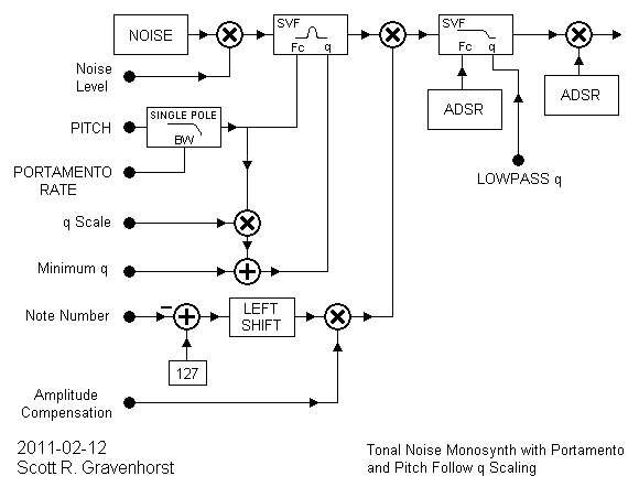

This is some blah blah regarding the last few days I've spent researching how to implement tonal noise using digital methods.
I've done tonal noise digitally by modulating the pitch input of an NCO with noise. This works, but didn't give me the noise character I wanted. Among the issues with it's implementation is that a digital synth works very much like a linear pitch VCO internally. This causes the modulation effect to be greater for lower pitches than it is for higher ones. This is because the difference between the values that move one semi tone are greater for higher pitches than for lower. If the modulation signal is not increased for higher pitches, then the noise effect is lost as pitch is increased. I compensated for this by using the note number to increase the amount of modulation as pitch (note number) is increased. This sounds good, but didn't really sound like what I wanted. It has the advantage of allowing different waveforms to be used in the NCO which "colors" the character of the sound.
This particular project is different than the one I described above. Another method to make tonal noise is to (basically) send noise into a tunable bandpass filter with high Q capacity and use the Fc input to control the pitch. In this project, I used a state variable filter because it is easy to tune and easy to set Q. However, a state variable filter presents some challenges. First is what is known as "Q enhancement". Q enhancement is the property of this (and others) type of filter that causes apparent Q to increase as Fc increases. The problem here is that an input of constant amplitude will eventually cause instability in the filter as Fc is increased (assuming a constant Q greater than 1). I handled this by what I call Q compensation which amounts to using the Fc signal to decrease Q as Fc increases. This works to quell the instability, but the system still presents an amplitude "enhancement" that causes the output to increase as Fc increases. I designed a simple amplitude compensator using the MIDI note number as it's input and decreasing the amplitude as note number (and hence Fc) increases.
I've included the block diagram of the system for your perusal and later today or tomorrow I will try to post some sound.
Note that in the block diagram, signal Q is not present - rather, a signal called "q" is which represents 1/Q.
Block Diagram of Tonal Noise Monosynth Sound Generation Hardware

See the second block diagram image for the new and improved synth. I've added another bandpass SVF between the white noise source and the level multiplier. This essentially creates a 4 pole filter and provides for a much deeper out of band attenuation of the noise signal. I now get a much cleaner tonal noise, somewhat reminiscent of an airy flute or whistle.
I am now working to regenerate the sound file using the new version of this monosynth and I will leave the first one here for comparison. It should be posted later today.

This is where the quest for tonal noise took me. It required wide arithmetic data paths and high sample rate. SR=800 kHz and data paths are 35 bits wide. The filters' delay cells are 70 bits wide. I think my quest is now over. I was hoping to cram two of these into one FPGA, but the FPGAs I have are a little too small, this design takes about 57% of the real estate.
Curious to which development board you used Scott? I really like the way you normalized the gain and q factors over the band. That second SVF really knocks the unwanted noise down ! This is cool and sounds sweet.

It runs on a Spartan-3E Starter Kit - and it's output is coming from the onboard 12 bit DAC.
The normalization isn't perfect, but it helps quite a bit. I may still mess with it by using methods other than simple linear compensation, especially for amplitude.

I should mention that the reason for using the Spartan-3E Starter Kit board was precisely because of the 12 bit DAC - which is capable of sample rates up to 1.0 MHz. In fact, I tried to get it to work at 1.0 MHz, but the combinatorial 35x35=70 multipliers won't clock at the 50 MHz required to get a sample rate of 1.0 MHz. Dropping the system clock from 50 MHz to 40 MHz with a DCM works for the multipliers and allows a max sample rate of 800 kHz.
The high sample rate enhances the quality of the LFSR noise. An LFSR has a spectrum that looks like a comb with the teeth moving closer together as the LFSR is made longer (hence I used a 64 bit shift register) and the spectrum has better high frequency content at higher sample rates. You can hear the effect of sample rate if you've ever run one from a VCO as the clock and sweep it. As you increase the clock, you can hear more and more high frequency content. I suppose one could say that the noise output gets whiter sounding as the sample rate increases.
The high sample rate also benefits the SVFs since they don't work well at Fc above 1/6 of the sample rate. 800 kHz gives a serious amount of headroom where 1/6 is 133.3333 kHz. I wanted a noise stream that sounds as much like analog as possible. My ears can't tell the difference.

Scott
I see the the MIDI note number is used for amplitude compensation but is the PITCH, controlling Fc of the second SVF, derived from the note number also?

Yes, the MIDI note number supplies pitch by addressing the tuning ROM, the data from which is used to generate Fc. The tuning ROM raw output delivers a pitch higher than standard (A440 tuning) so I multiply the ROM values by a tuning factor between 1.0 and 0.0 to get tuning to match other instruments. The tuning multiplier value is supplied by sysex from (in my case) a VB.NET program.
Also, the pitch value is sent to both the first and second SVF Fc input. The first has a constant Q of 0.9999999, the second has a Q that can be adjusted and would normally be rather high. In the demo piece it was set to 2000. So the first SVF doesn't really give perceivably pitched noise, but it does narrow the bandwidth of the noise on either side of Fc. The second high Q SVF is the one that actually makes the noise pitched. The first one serves to prevent a serious SHHHH sound by rolling off the noise near Fc. The two SVFs together basically form a 4 pole bandpass filter. I thought about two different scenarios for the bandpass filters - 1) the way I did it and 2) put the same q and Fc signals into both filters. I have not tried #2 yet, but I was afraid that it would give too much of a sinusoidal sound and I wanted an obvious pitched noise. And now that I look at what I wrote, I realize that the best solution would be to allow adjustable Q on both filters...
