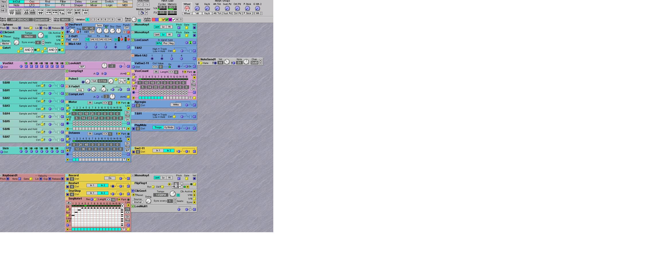

Hi all!
First, it's REALY nice to be there. I had a G2X 5 years ago. It's now time for me to get back up to date with my new G2.
I play with an arpegiator patch but sometime the pitch is wrong or I hear glitch. I have the feeling that the clock is unstable.
Is it because my arp patch is on slot A and my synth patch is on slot B ?
When I search on the forum I find this topic :
http://electro-music.com/forum/viewtopic.php?highlight=clock&t=56557
Is it my problem ? Can I have to use a Clocked Delay with value "5" ? Im trying now without succes.
Is it the clock from the G2, can I fix this issue if the G2 is on slave mode ?
I upload the patch. You can hear the glitch, desync or wrong pitch note after 5 seconds, less or more.
Thanks !

Yes, I can hear the unwanted glitch in your patch, but it does not appear to be related to the sequencer step delay problem that I described in the link that you posted here. Instead, it appears to be related to a problem with the record function of the sequencer module at the bottom of column 2 in Slot A. When I disconnect the Record value and gate inputs of this sequencer, then the patch runs normally without any glitches Shocked That’s weird Exclamation

You're right! As soon as I plug a wire into the Record value and gate inputs of this sequencer, the glitch start. I have to dig into the record function of the sequencer modules. Yesturday I see a new patch from Tim Kleinert to record MIDI note (60 seconds). I will check this patch too.

I did a test that confirms that connecting any signal to either of the Note Sequencer module Record inputs causes the pitch step output to be delayed by a few DSP cycles, but NOT the trigger/gate output Shocked This pitch step delay is in *addition* to the already confirmed sequencer modules control signal and trigger/gate step delay reported here:
http://electro-music.com/forum/topic-56557.html
This problem really is a bug because of the trigger/gate output always occurring before the pitch step change.
So, in the perf attached in the original post above, the pitch step value is always (or almost) one sequencer step behind when the trigger output occurs.
A workaround for this bug, for example, is to add a Logic Delay module between the trigger output of the Note Sequencer and the gate input of the MIDI Note Send module as is done in this perf fix:

Yes Tim is right (arno too!) but thanks to you to find the bug in my patch. And you find a workaround (same as arno reported before) Smile
