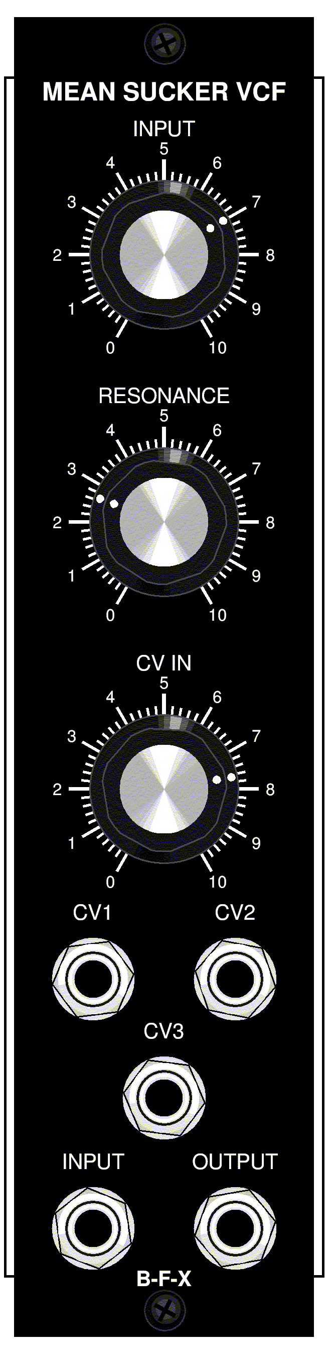

janvanvolt
Joined: Nov 24, 2005
Posts: 285
Location: Mainz, Germany
PostPosted: Wed Jan 16, 2008 9:22 am    Post subject: Reply with quote  Mark this post and the followings unread
Will have my pcb ready next week; i have designed a lovely frontpanel for dotcom:
Mean Sucker VCF DOTCOM Frontpanel
 Filesize:  127.63 KB
 Viewed:  865 Time(s)
My dIY - http://diy.czmok.de
Film/Music - http://gfm.me
