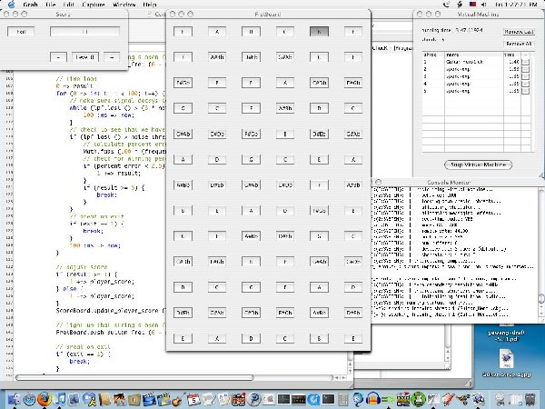

Well, I went ahead and did it, coded up 400 lines of MAUI code to create ChucK Guitar Hero. You'll see in the screen shot a scoreboard window with exit button and level selector, plus the fretboard. When an open string (indicated by fret 0) opens up, you play that note and if you do it right, ChucK hears the note and scores you a point. After a certain time (about 10 seconds) a negative point is added to the player score. So you gotta keep up, mistakes are tolerated, but there are limits to the forgiveness. Thoughts or suggestions anyone?

Well, there's a reason. When I tried to use FFT to create a guitar tuner i found that it was very coarse or required a huge sample set to get down to that resolution. Also it is computationally expensive. However, yes, FFT is one of the tools in our toolbox to try out. First, though, i used band reject filters to reject unwanted armonics and they worked great. I looked on my scope and it turns out that the low "E" string has tons of energy in the third harmonic, the period looks more like the letter "m" than anything else, with an extra zero-crossing peak in the middle. Yuck!
So I added three band reject filters and they took care of that. I'm still getting some false positiiiives, but at least the basic notes are correctly identified. I'll keep workng on it... _________________ "Let's make noise for peace." - Kijjaz |

Then again... I've experimented some more with it and proper note detection remains a mystery. Maybe your ealier idea of "riding the RMS" will be handy, and also the FFT may be useful even without the frequency accuracy. I'm going to have to really think this one out to make it work. PLEASE offer any suggestions you may have! Also, gameplay suggestions like "it would be cool if..." are welcome! _________________ "Let's make noise for peace." - Kijjaz |

Hot dog! The comb filter worked. I just comb filtered with negative feedback and positive coefficient at the expected freqency, and it created a guitar signal grabber thingie! Then I just take the RMS and divide it by the overall signal to get a ratio that can be compared to a threshold. There are rare occasions when I get a false success note, but those are tolerable. Whew, with the right inspiration and a little Wikipedia, that problem is solved! _________________ "Let's make noise for peace." - Kijjaz |

Hmmm, it occurs to me that the algorithm may be flawed. For a desired guitar signal, the comb filter output divided by the overall signal output would be greater than 5 because the algorithm is working. However, any noisy input will also pass the algorithm because of the gain of the comb filter.
I still think the comb filter is the cat's meow for this application, but clearly a guitar game that just adds up scores in response to arbitrary music/noise is lame and needs some work! Getting there, just not there yet. Suggestions welcome as always. _________________ "Let's make noise for peace." - Kijjaz |

I've got the Guitar Zero game to revision 9 which seems fairly stable, so I am posting it in both Linux/PC test form and Mac MAUI form. The Linux/PC version just stays in Level 1 while the Mac version starts in Level 0 and you can advance levels with the level button.
The program tells you a string number and a fret number and you are to play that note on your 6-string guitar through your guitar amp and let the computer's microphone hear the note. If correct the computer will beep, print an updated score, and advance to the next note. If incorrect you still have time to type the next note (total of one second) before the timeout, a buzzer sound, and an updated score.
I'm open to suggestions as to what to do next with it. Enjoy!
