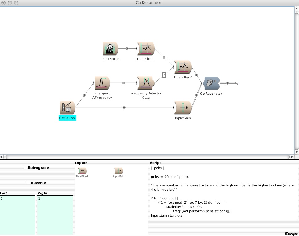

Hi Guys,
I know there are a few guitar players here interested in Kyma so I thought I would post this here.
It is a sort of resonator patch based on an example that comes with Kyma.
It is early days as I am still working on it but I quite like the sound of it.
There is an MP3 example attached and also an image of the patch which is a Clean guitar signal into Kyma and into Waves GTR providing some compression, a little chorus and a delay and into a warmish amp.
So how does the patch work (there is an image down the bottom)?
GtrResonator is a script which is used to "create" multiple instances of the modules to the left of it. For each instance of the modules It creates a variable called ?freq which it passes to them, more on this latter.
PinkNoise is a Pink noise generator.
DualFilter1 is a dual parallel two pole bandpass filter. The first filters frequency is locater at ?freq and the second at ?freq + 7 semitones. The bandwidth of the first filter is 11Hz and the second is 30Hz. The amplitudes of these filters are fixed.
DualFilter2 is also a dual parallel two pole bandpass filter. The frequencies are the same as the other filter but the bandwidths are 1Hz and 2Hz. The amplitudes of these filters are not fixed, they are set from a smoothed envelope provided by the FrequencyDetectorGate. This amplitude of this envelope can be attenuated by midi or a Kyma gui.
GtrSource is the source for the guitar.
EnergyAtFrequency is used to generate an envelope showing how much energy is at the frequency defined by ?freq. The release time of the envelope can be changed via midi or gui.
FrequencyDetectorGate is a Kyma Threshold module. The threshold and hysteresis can be modified via midi or a gui. So basically this is allowing us to gate the envelope based an an amplitude threshold.
This gated envelope is then fed into DualFilter2 to set the amplitude of the filters.
InputGain is just used to set the original guitar level to output based on midi or the gui.
So now we get back to the script in GtrResonator. This is a smalltalk script which is used to create the "Sound" based on the modules to its left in the signal chain.
Here is the script:

Lets look at it a bit at a time:
Code:
|  pchs |
pchs := #(c d e f g a b).
The above is declaring a variable that is a collection of the whole notes c, d, e, f, g, a, b
Code:
2 to: 7 do: [:oct |
This is a loop. It is looping through octaves 2 to 7, each time through the loop the variable oct is set to the octave. so oct will have the vales 2 then 3 then 4 then 5 then 6 then 7. So it will travel through 6 octaves.
Code:
((1 + (oct mod: 2)) to: 7 by: 2) do: [:pch |
This is also a loop which looks pretty complicated so lets take it a bit at a time.
The start of the loop is defined by the following
Code:
(1 + (oct mod: 2))
mod: is a modulo operator which in simpler terms is the remainder left after an integral division. Wikipedia has a confusing section at http://en.wikipedia.org/wiki/Modulo_operation for anyone interested.
Here is a table showing the result for the different results based on the value of oct:
Code:
oct   (oct mod: 2)   (1 + (oct mod: 2))
2      0         1
3      1         2
4      0         1
5      1         2
6      0         1
7      1         2
So the mod: basically it is just a way of alternating between 1 and 0 for each octave. We than add 1 to it so we are alternating between 1 and 2 based on the octave.
Code:
to: 7 by: 2
The above just means that no value can be greater than 7 and each time around the loop :pch will be incremented by 2.
so lets have another table showing the octave and the values that :pch will get around this loop.
Code:
oct      pch values
2      1, 3, 5, 7
3      2, 4, 6
4      1, 3, 5, 7
5      2, 4, 6
6      1, 3, 5, 7
7      2, 4, 6
Now these values are going to be used to lookup note values in the pchs collection (c d e f g a b), index 1 is c, index 2 is d etc.
The following returns the note at an index defined by :pch
Code:
(pchs at: pch)
So we Get:
Code:
oct      pch values      Note values
2      1, 3, 5, 7      c, e, g, b
3      2, 4, 6      d, f, a
4      1, 3, 5, 7      c, e, g, b
5      2, 4, 6      d, f, a
6      1, 3, 5, 7      c, e, g, b
7      2, 4, 6      d, f, a
So basically what we have done is slip the whole notes roughly in two and assigned them to different octaves.
Now the inside of the inner loop looks like this:
Code:
DualFilter2    start: 0 s
   freq: (oct perform: (pchs at: pch))]].
This is creating a new instance of the DualFilter2 module which also creates a new instances of DualFilter1, FrequencyDetectorGate and EnergyAtFrequency.
It is starting this immediately using "start: 0 s" which means start at 0 seconds and is passing a parameter (:freq) defined by "(oct perform: (pchs at: pch))". This :freq parameter is placed in the ?freq variable for the instances.
Ok nearly there!
Code:
We already know that (pchs at :pch) is looking up the note in the collection. perform: is used to send this note as a message to oct.
So the first time arounfd the loops oct will equal 2 and pch will equal 1 so we will get the following placed in ?freq:
2 c
In kyma this is a note definition for c at octave 2.
The next time round the loops we will get
2 e
So we will end up with 21 new instances of the DualFilter2, DualFilet1, FrequencyDetectorGate and EnergyAtFrequency chain. Each will be using different frequencies set by the following notes:
Code:
2 c,    2 e,    2 g,   2 b
3 d,    3 f,    3 a
4 c,    4 e,    4 g,    4 b
5 d,    5 f,    5 a
6 c,    6 e,    6 g,    6 b
7 d,    7 f,    7 a
So what does it all mean then?
When you play a note on the guitar the 21 EnergyAtAFrequency modules are generating envelopes based on the energy in the signal at the pitches defined above. These envelopes are then used control the amplitude of the bandpass filters at the same frequency letting various frequencies of the Pink noise through to the output.
This might wet your appetite to what is possible with Kyma scripting, or it may make you think bugger that wheres my pedals.
Andy

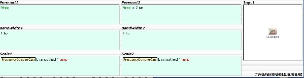

The only thing I don't quite get is why DualFilter1, FrequencyDetectorGate and EnergyAtFrequency are instantiated with each explicit instance (as done in the script) of DualFilter2. I'll just accept that they are for now. Also, what does the little box with a "2" in it on the output wire of FrequencyDetectorGate mean?
(The module names in the explanation of the script are different from those in the picture of the patch, which had me scratching my head for a moment...)

Sorry about that, I have replaced the image. The previous one was from an earlier version.

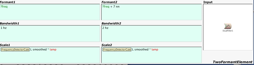

I think it is as follows:
When a DualFilter2 is created, Kyma looks back at the chain of modules feeding into it. If a module uses the variable ?freq it also creates an instance of that module using the value of freq that DualFilter2 has been given by the script. DualFilter1 and EnergyAtAFrequency use ?freq. FrequencyDetectorGate (and here I am guessing) is created as one of its inputs has been created.
I am not fully sure of the rules yet as I haven't read this part of the manual. I will have a look and report back with some more knowledge.
The little 2 signifies that the preceding module is used twice by the module to the right.
Dualfilter uses it to set the amplitude of both of the filters which are set via Scale1 and Scale2 shown in the included image. The L means use the left input, smoothed meens interpolate changes over 100ms, the !amp is a hot variable that can be set by midi or say a slider in the gui.
Aha - so in effect ?freq becomes a vector when the script runs and thus everything that references it get instantiated... ok. I assume that if you reference a variable, e.g. ?freq, in a module before it has been defined, e.g. by the script module, it is simply seen as void (hmm... or is it here that Kyma requires a user-initiated compilation step and would flag an error for referencing an undefined object...)
Anyway, I begin to see what the power of Kyma is about. It'll be interesting to see a similar'ish hexaphonic guitar patch some time Smile

If you run a sound that hasn't had the ?variable defined Kyma asks you for it in a dialog windows and then runs with the value you enter.
