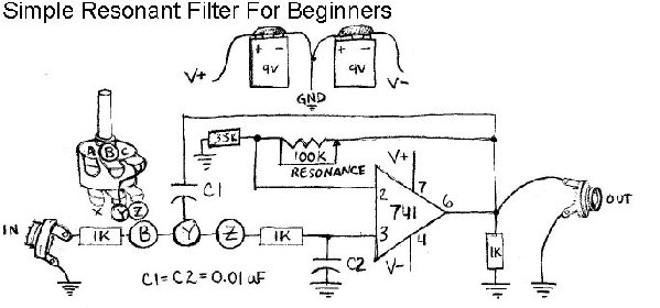

PostPosted: Thu Jun 11, 2009 1:05 pm    Post subject: Reply with quote  Mark this post and the followings unread
well, I finished my schematic with appropriate component values. I'm attempting to attach it in this post. (I'm not so net savvy, so I type this, post it, see what happens, and if I flub it I'll edit and try again...)
The funny looking pot on the left is a dual (stereo) 100k pot (which will control cutoff). The points are labelled and should be connected to the corresponding points in the circuit.
The resonance pot shown is 100k. It will start oscillating at about 50%, this can be very unpleasant. You can use a 50k here and it will cut before self-oscillating. I like the 100k better because you can get squelchier highs out of it.
Please note this is not set up for voltage control, you have to physically play with the two pots to get sweeps.
I take no credit for the design of this circuit, it is culled from a couple of public sources, however, if there are errors they are my own.
Please note that the points labelled "C" and "Y" on the dual pot must be connected.
Anyway, have fun with this one, to me it sounds great, especially for how simple it is.

PostPosted: Mon Jun 29, 2009 6:28 am    Post subject: Reply with quote  Mark this post and the followings unread
A question for Comrade_zero
I found the time to test your circuit on a breadboard but does not work ...
I have a doubt about the connection of the dual potentiometer.
scheme seems that items B Y and Z are connected together ...
But in doing so how do you work?

PostPosted: Mon Jun 29, 2009 8:50 am    Post subject: Reply with quote  Mark this post and the followings unread
Looks as if he has a jumper drawn between Y and C of the dual pot, doesn't it? Or you could just use a 200k....

PostPosted: Mon Jun 29, 2009 9:48 am    Post subject: Reply with quote  Mark this post and the followings unread
yes, but I have the impression that connected as I understand the scheme, are all linked together ...

PostPosted: Mon Jun 29, 2009 10:09 am    Post subject: Reply with quote  Mark this post and the followings unread
You are correct -- the schematic is drawn incorrectly. B, Y and Z are not connected together. They are connected to the corresponding points on the dual pot.

PostPosted: Mon Jun 29, 2009 1:52 pm    Post subject: Reply with quote  Mark this post and the followings unread
heheh, sorry for the confusion. I mentioned the wiring of the dual gave me trouble...
1) yes, you need a dual pot, not just double the value. The Sallen-Key topology depends on two equal resistors, the dual pot in this case serves that purpose.
2) yes, the schematic is wrong, sorry for that. ERASE THE LINE CONNECTING "B" and "Y". Also ERASE THE LINE CONNECTING "Y" and "Z".
remeber, though, Y connects to two places, it is jumpered to point C of the dual, and it also is connected to Capacitor 1.
I'll try to get a corrected schematic drawn to replace the faulty one. Sorry for the inconvenience, and thank you for giving this circuit a go.

PostPosted: Tue Jun 30, 2009 5:02 am    Post subject: Reply with quote  Mark this post and the followings unread
ok, now seems to work...
but the sound is heavy distorted...
I played a bit with the capacitors ...
Ceramic is right? (not electrolytic)
the resistors are in place and IC is a UA741CN
on capacitors says k5m 104 (small orange)

PostPosted: Tue Jun 30, 2009 9:35 am    Post subject: Reply with quote  Mark this post and the followings unread
I'm glad your getting sound out of it. Try changing your capacitors to 0.01uf ceramic disc capacitors. They should be labelled "103." Hopefully that will clean up the sound a bit.
The volume of your input signal can also affect the amount of distortion.
