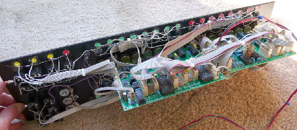

Ok, this has been quite a project! I am very happy to be done building. Everything looks like it works. My Klee is Kleeing and Klonking happily. Now to calibrate and learn how to program it. I love what I hear so far. Stay tuned for a youtube video soon. Fun fun fun!
A big thank you goes out to all who contributed to this awesome project.
pete

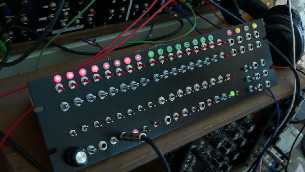

The LED bezels worked out great. They disperse the light nicely.

Is that a 3 high rack panel? If so, that's fairly economical on space.
I, too, like your LED arrangement.

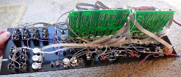

Great job. I like the use of the ribbon cable as it is very space efficient. Very Happy I agree also, great use of panel space .....

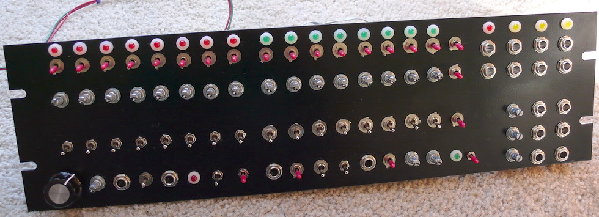

Thanks guys! The rack panel is three spaces. Its took a bit of planning to make everything fit. I used Fonik's old rack panel as reference. I actually have a tiny area to fit a few extra bits in the future, in case folks come up with some mods. Check out the video, I just finished uploading it earlier today.

Thanks! I put a lot of work into it as you can see. I went the old school route and drew the panel design onto paper and taped it to the panel as a guide for drilling. I drilled everything by hand. Its not totally aligned, but its functional. Well my Klee does work as long as I don't flip step switch 15. I ordered two CD4034's from Digikey along with some of those Panasonic SMD tempcos, I have heard so much about.
