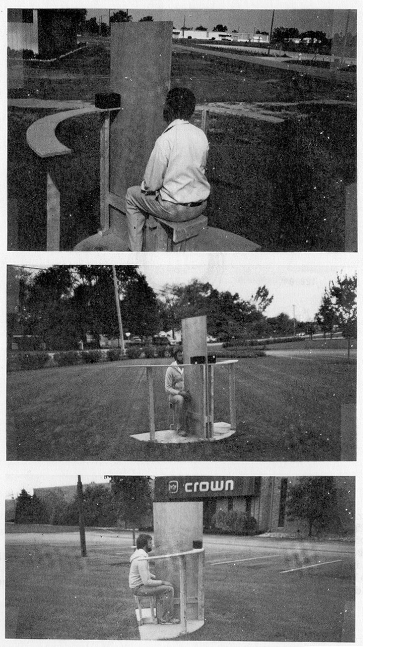

In another topic,
http://electro-music.com/forum/post-198597.html#198597
Durwood pointed out this excellent paper by DB on Interaural Crosstalk.
http://www.xlrtechs.com/dbkeele.com/papers.htm (paper #1Cool
The author describes a physical barrier type system for listening where the barrier isolates the two speakers and eliminates crosstalk; the goal of crosstalk canceler signal processors like RACE or MAP. I think he does a commendable job explaining the undesirable effects of crosstalk.
This paper is highly recommened. I plan to refer to it in my talk on ambiophonic sound at electro-music 2008, http://event.electro-music.com
Keele barrier crosstalk canceler circa 1986
