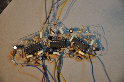

I've built a few of Pete's smaller circuits, and laboriously soaked the paper in water and removed it from the circuit - happy hours with tweezers!, I then mounted the bare circuit on hardboard using acrylic paints/paste - incorporating the electronics onto the surface of a painting. I drilled holes through the board for short lengths of brass rod - about 3mm diameter - for the contact points. Likewise mounted a speaker from the back, with a painted grille showing on the front. The wiring between circuit and contacts, and the battery, are hidden behind the painting.
Acrylic paste is a pretty good adhesive. You do have to let it dry thoroughly though - the first time I tried the circuit too soon, and it didn't work - unset acrylic has a resistance in the high k/low megaohm range! Once dry it is an insulator.
His circuits are brilliant noisemakers. I now need to find a way to incorporate them in my embryonic modular.

Ok, here are some pictures of my paper circuits. Some parts of a Rollz-5 - on the paper, and after stripping the paper away. Then a Lil Sidrassi embedded in an acrylic painting. The contact points are short lengths of brass rod sticking up about 15mm. Played with fingers- best when wet. The speaker is behind the red blob in the bottom left corner. The red spot on the right is a push-button on-off switch for the battery.
(Sorry about the file sizes, first go at posting images)

That's pretty amazing. Embedding it into art like that.
