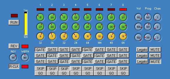

Well, I'm still working on it. I'm finding the skip function difficult to impliment. Here's a screen shot of what I have so far...
Screen shot of work in progress using Artwonk.
Howard,
This is a good example of the difference in implementing a classical analog sequencer and in emulating one in a program like ArtWonk that is intended to co exist with more demanding programs like soft synths, and so runs at some discrete clock rate and then goes to sleep between ticks.
With analog, when the skipped stage is reached, it simply zeros the clock time, perhaps by shorting the r/c capacitor in the timing circuit, and the stage is (practically speaking) instantly skipped. But in order to skip a stage with ArtWonk, it has to be removed entirely from whatever is sequencing it; it is not enough to just skip over it very fast because the fastest that can happen is the tick rate, which will likely produce an audible blip.
With ArtWonk this can be done by using an array to map the steps. When a skip switch is depressed, the switch change triggers a function that puts a 0 in that array position, then hands it off to another function that sorts the array and returns the new count of sequence steps used. The sequencing clock then sequences not a direct count, but the mapped positions of whatever states are not skipped.
I've implemented this as an ArtWonk macro. It's on the Algorithmic Arts user's forum, in Patches, Macros & Functions.
