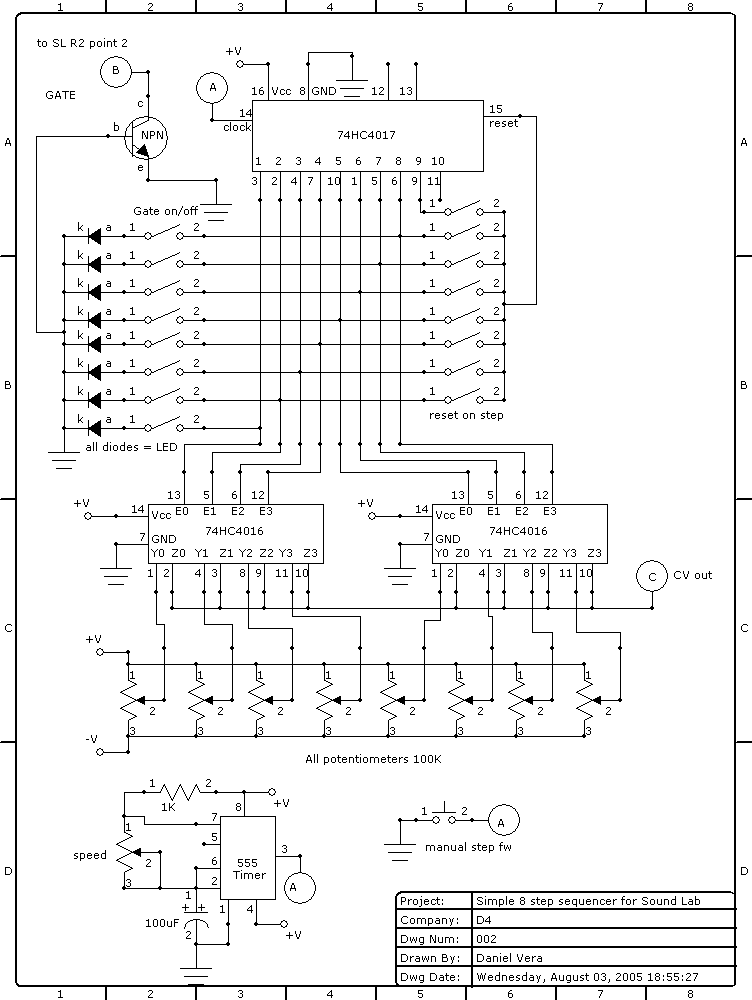

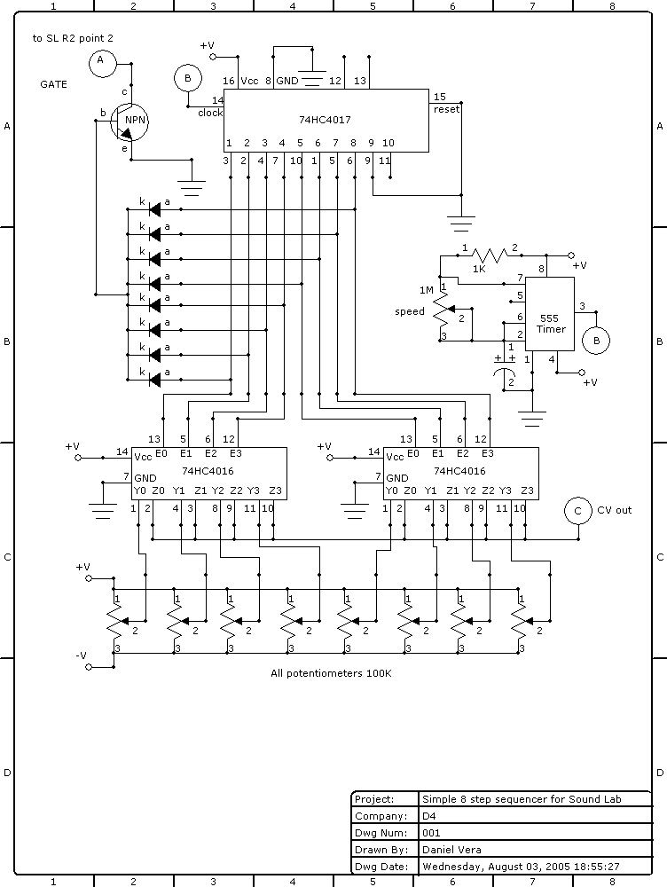

so here is what i suggest:
*[this is the first version - scroll down to see resent versions]*
it uses
74HC4017 Johnson decade counter with 10 decoded outputs,
74HC4016 Quad bilateral switches.
and 555 timer
the value of the capacitor on 555 timer circuit is still unknown but i will try and breadboard this soon to see if it works, and then i will know the value of the capacitor.
there will also be option to add leds to every step and to reset on other than the last step
if you see any mistakes i made, please notify so we can make this work
hope this works
and if you want to ad something to the schematic. i can post the schematic in .sch-file (RJWsoft schematic publisher)
daniel

PostPosted: Wed Aug 03, 2005 3:49 pm    Post subject: Reply with quote  Mark this post and the followings unread
those diodes could be led's too?- as you are running 4016's off a 4017? :D
Or are they meant to be led's? :oops:

PostPosted: Wed Aug 03, 2005 8:49 pm    Post subject: Reply with quote  Mark this post and the followings unread
v-un-v wrote:
those diodes could be led's too?- as you are running 4016's off a 4017? Very Happy
Or are they meant to be led's? Embarassed
they are first drawn as diodes - but your right, those can be leds.

PostPosted: Fri Aug 05, 2005 11:12 am    Post subject: Reply with quote  Mark this post and the followings unread
just had my proto board set up - and here it is
flash animation
so here is some comments:
on the first schematic there is a mistake - : connect the cathodes of the leds to ground.
the cap on 555 timer is 100uF.
there is a need for fine tuner for the clock circuit.
(the range is very wide)
if you want to "walk" the steps manually connect the point A to ground via momentary push button.
there is some problems resetting the steps (if you want to reset before it hits the last step)
i will draw new corrected schematic soon

PostPosted: Fri Aug 05, 2005 4:15 pm    Post subject: Reply with quote  Mark this post and the followings unread
thanks guys i took a look on the suggested ics data sheets - but im in the very beginning of this electronics world - that i need to ask fore more detailed answers -or maybe a schematic to illustrate how to connect the things - thanks
now i have made some improvements to the simple 8 step sequencer:
DIP switches:
- to gate on/off
- and to reset on step
manual step forward button
when all potentiometers are 100K then there is no need for fine tuning.
if you want to reset before it hits the last step just close one switch from the reset DIPswitches (but just one - if you close multiple switches it results as weird blinking - what can be of course used as an effect)
(should i remove the first schematic?)
mosc: i was thinking to ad some Schmitt trigger-based simple osc´s to the bilateral switches. so that on one step i might have two osc´s and on the other four or something... that might result something interesting...
i am so exited of all this things that i learn by experimenting and asking.
thanks for your patience i really appreciate the lessons i get here at EM-forum
daniel
[edit:added comment on the reset switches]

PostPosted: Sat Aug 06, 2005 7:02 am    Post subject: and another cup of coffee..... Reply with quote  Mark this post and the followings unread
Dnny, I don't want to state the obvious (I will) but shouldn't the reset switches just come from one single rotary? All those switches would be expensive and pointless. The gate switch idea on the other hand is excellent.

PostPosted: Sat Aug 06, 2005 7:40 am    Post subject: Reply with quote  Mark this post and the followings unread
When you close two ore more switches you are effectively shorting outputs of your counter which could give some funny effects.
You could prevent this by inserting a diode for each switch, or by using a rotary switch instead of the dips (as Tom suggested). But even with the rotary you might want to use diodes, unless you are sure the rotaries steps don't overlap.
As Howard suggested it would be interesting to make inputs for the analog switches instead of just pots. Not only to sequence audio signals, but using one or more LFOs instead of (a) pot(s) could be interesting as well for generating sequencer variations. You could just add some input conectors with switches built in that select the pot when nothing is inserted. Maybe you could even come up with someting where the pots would work as input attenuators for the inserted signals ... but that doesn't seem to be easy :-)
Jan.

PostPosted: Thu Aug 11, 2005 5:19 am    Post subject: Reply with quote  Mark this post and the followings unread
I realised this arvo that I have a collection of SPDT mini toggles that are centre off. When I have a go at this sequencer I'm going to use those so that each step has the choice of CVonly(centre), +Gate, and last step all on one switch. Combined with the cascaded 4017 idea to give 16 outputs this would result in a very cool and still simple sequencer. Next thing is to dial up different banks of flip flops with a rotary and we have almost built a Dr Rythm!!
