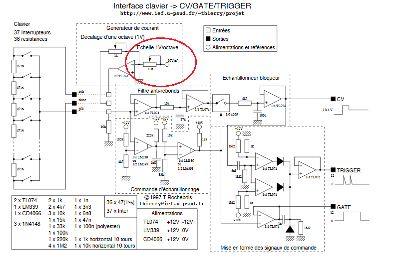

has anybody attempted to build the "keyboard interface CV-GATE-TRIGGER" circuit?
it looks really nice and low components count.

PostPosted: Tue Sep 06, 2016 1:23 am    Post subject: Reply with quote  Mark this post and the followings unread
Hi
No I haven't built it, but it was a student project that was successfully completed and the schematics published by Thierry were all tested therefore I guess you may be pretty confident in these. I see no flaw in them.

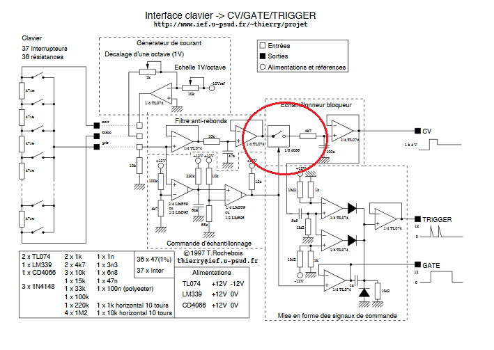

i am about to build the following keyboard CV GATE TRIGGER circuit that calls for a CD 4066 for the sample and hold section.
I recently got a bunch of CD 4016 ,i'd like to know if i can use it in place of the CD 4066 the circuit specifies. thanks folks !

PostPosted: Tue Oct 25, 2016 10:19 am    Post subject: Reply with quote  Mark this post and the followings unread
Yes you can

on the far left of the schematics,I see three outputs from the keyboard circuit called, from top to bottom, "noir", "blanc" ,"gris" .
They are connected to the circuit by the means of "dotted lines". Are those lines to be considered as regular cables and connections?
is there any particular reason for them not to be drawn as the rest of the circuit connectionss?

PostPosted: Sat Oct 29, 2016 12:39 am    Post subject: Reply with quote  Mark this post and the followings unread
alanwilder81 wrote:
thanks very much Yves !
another question.
thanks !
Yes they are connected. I suppose the dotted lines symbolise a ribbon cable with connectors on each side that interconnect the circuit board to the keybed board.

thanks Yves. another question.
at the moment i am using an extra -10 V power supply cable connected to the ""echelle 1 V octave"" trimmer. it works but it's only temporary.
What would it be a better and definitive solution to raise the voltage from -12 to -10 in that section?
many thanks!
 Filesize:  46.94 KB
 Viewed:  399 Time(s)
yusynth
Joined: Nov 24, 2005
Posts: 1314
PostPosted: Fri Nov 18, 2016 10:25 am    Post subject: Reply with quote  Mark this post and the followings unread
Or you can use a resistor, a 10V zener and a capacitor to create the 10V reference
Yves
