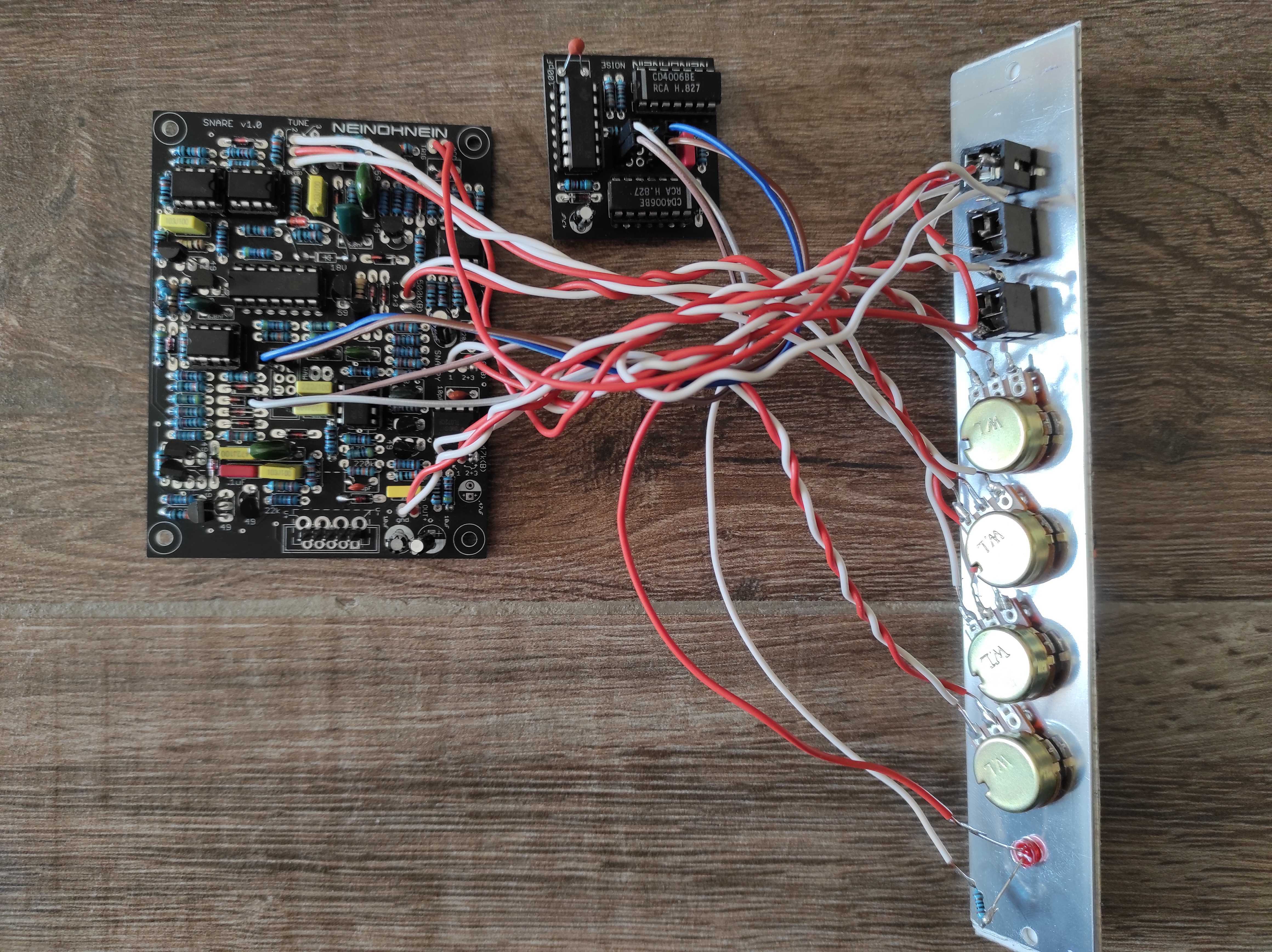

Hi everyone
I have finished building the NeinOhNein snare with noise module. I have used an official PCB bought online. It works, but I find three issues:
    - overtone always present in the background
    - tone pot seems doesn't to work
    - white noise is always present in the background adding snappy
How can I check what the problem Is?
I have checked many times connections and values without finding anything wrong.
I really appreciate any help you can provide.
Assembled NeinOnNein Snare + white Module PCB

PostPosted: Wed May 18, 2022 5:37 am    Post subject: Reply with quote  Mark this post and the followings unread
Ok, maybe I have solved the problem. It seems that Q1 and Q2 have pinouts inverted.
I replaced ZTX1051a with 2N3904 like say BOM sheet, but the suggestion is more ambiguous; it says "2N3904 should work if you cannot find ZTX1051! The For people that will build this module in the future ZTX1051a and 2N3904 have emitter and collector inverted. Keep attention!
