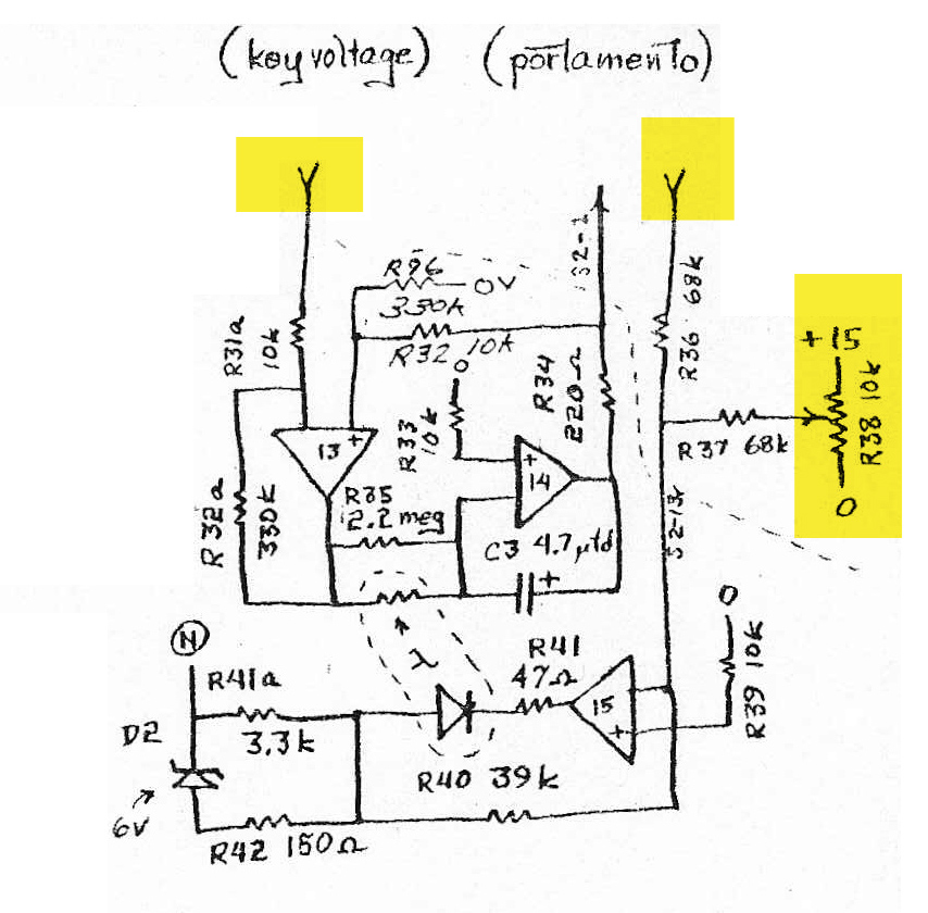

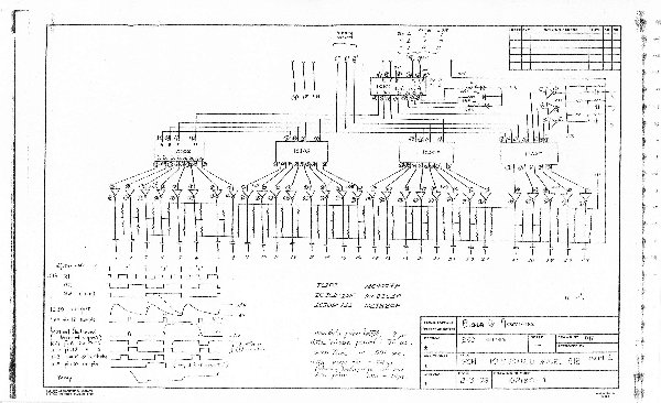

Last night I finally tested the slew circuit that I cloned from the Buchla 218 keyboard. I'm happy to say that it works. I've posted the schematic and a couple of sound samples below. I may have to do a bit of fine tuning... if nothing else I will try smaller cap values, since it's pretty easy to get way too much portamento going.

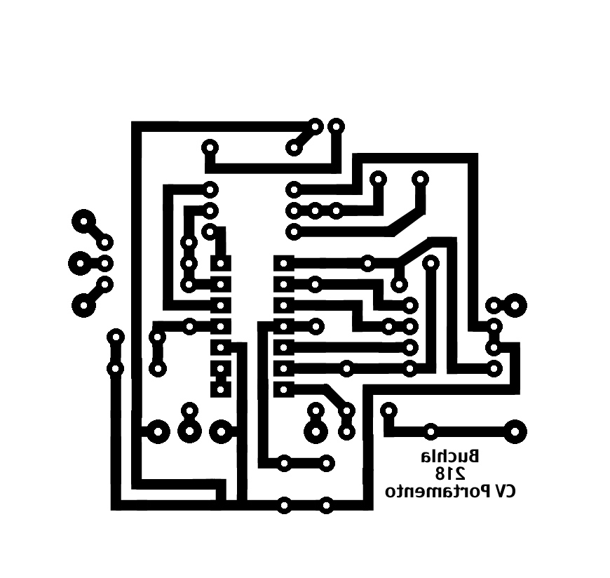

Update: I've uploaded the PCB layout, for those who like to roll their own.
 Filesize:  276.41 KB
 Viewed:  1374 Time(s)
PCB Layout. Works!

buchla_218_Slew_parts.pdf
Parts layout. Corrected diode part number.

What is the difference between Ground and N Ground? and what is L1 & L2?
thanks!
vtl5c3
Joined: Sep 08, 2006
Posts: 425
Location: PDX
PostPosted: Sat Jun 30, 2007 8:53 am    Post subject: Reply with quote  Mark this post and the followings unread
Quad wrote:
Thanks for posting!
thanks!
Noisy ground and regular (quiet?) ground. Buchla often had separate grounds in his modules. As you can see they join together on this PCB. No need to worry about the differences. L1 & L2 are ferrite beads, same as you find on most prefab DIY PCBs these days. You can use low value resistors or jumpers if you don't have ferrite beads.

In the schematic, it calls for a 6V Zener diode. But on your PCB diagram it says 1N5224. Isn't this a 2.8V Zener? What Zener did you use here? I don't know how crucial it is, as I have neither anyway. I'm a vactrol n00b and I don't want to fry them.

Good question. I'll have to check my work when I get home. You're correct that the 1N5224 is a 2.8 Zener. It should read 1N5233. Thanks for pointing it out.

The VTL5C4 would be slower than the usual VTL5C3 that Buchla uses. It's not spec'd here but I'm assuming it is a VTL5C3 in this circuit. The 'slower' would just be response to control changes, not the portamento itself. IOW, if you wanted quick turn-on and turn-off of portamento via control voltages it will have more lag time, especially the turning off or quick turning down of the portamento. Kinda like portamento'd portamento. Shocked

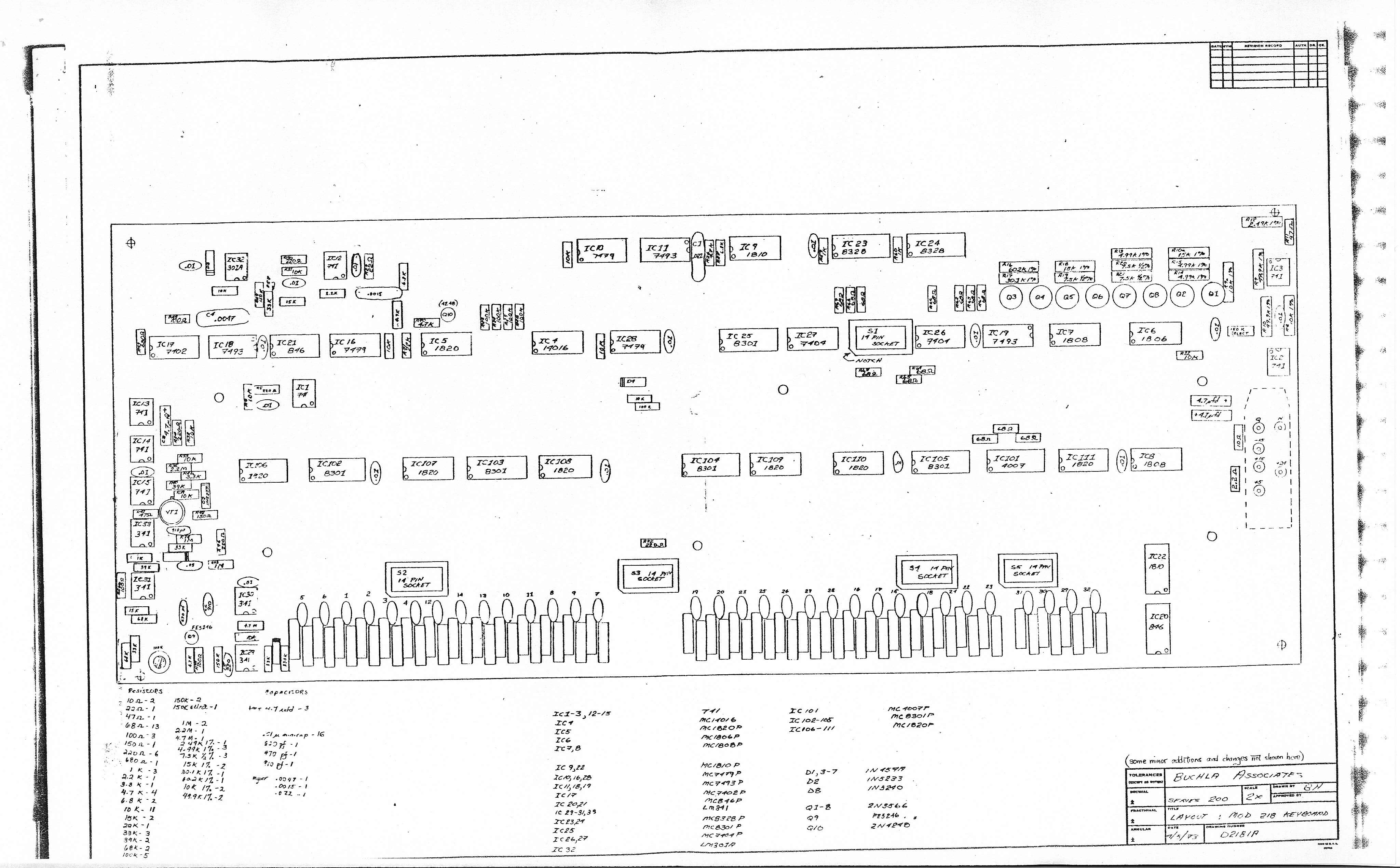

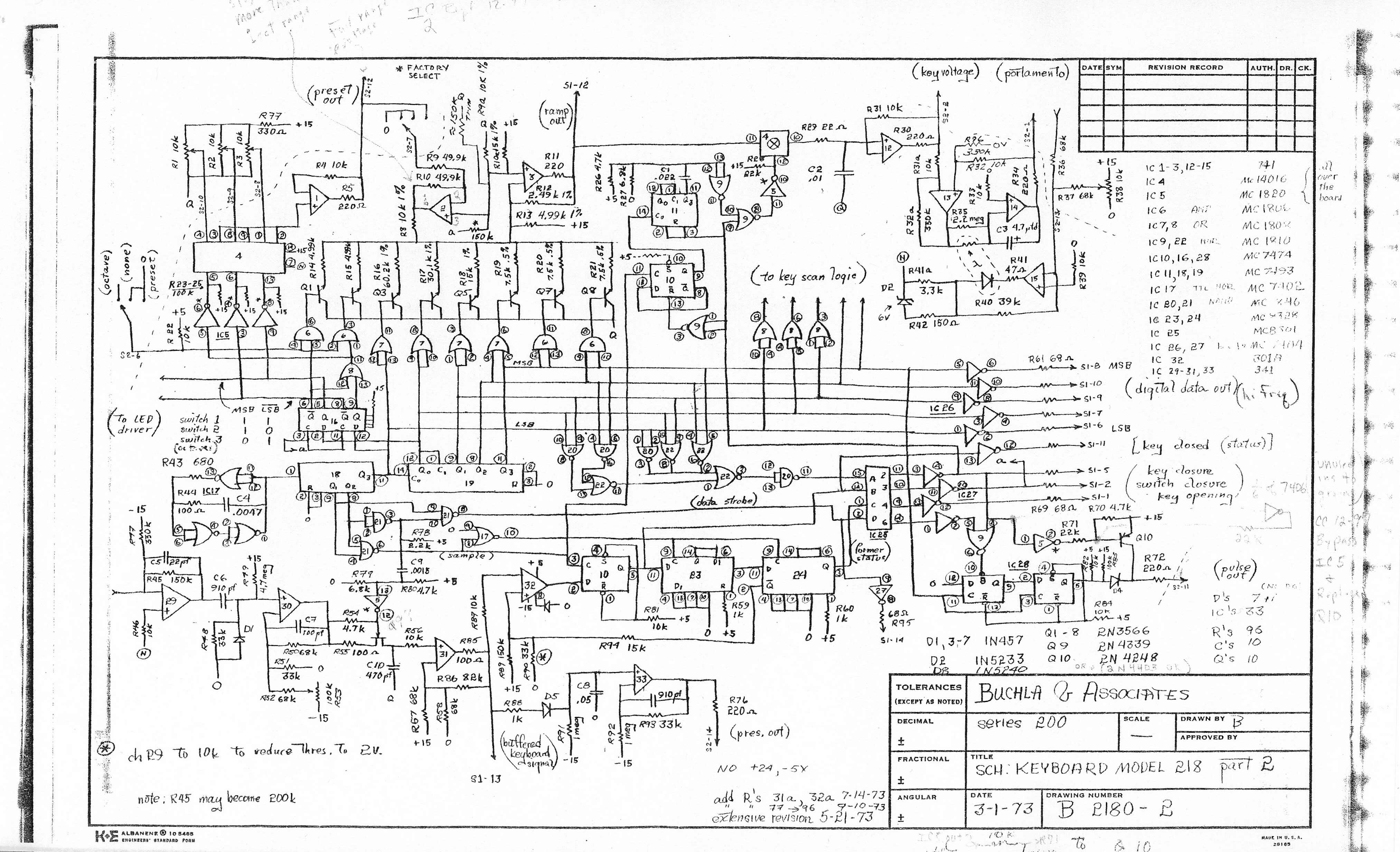

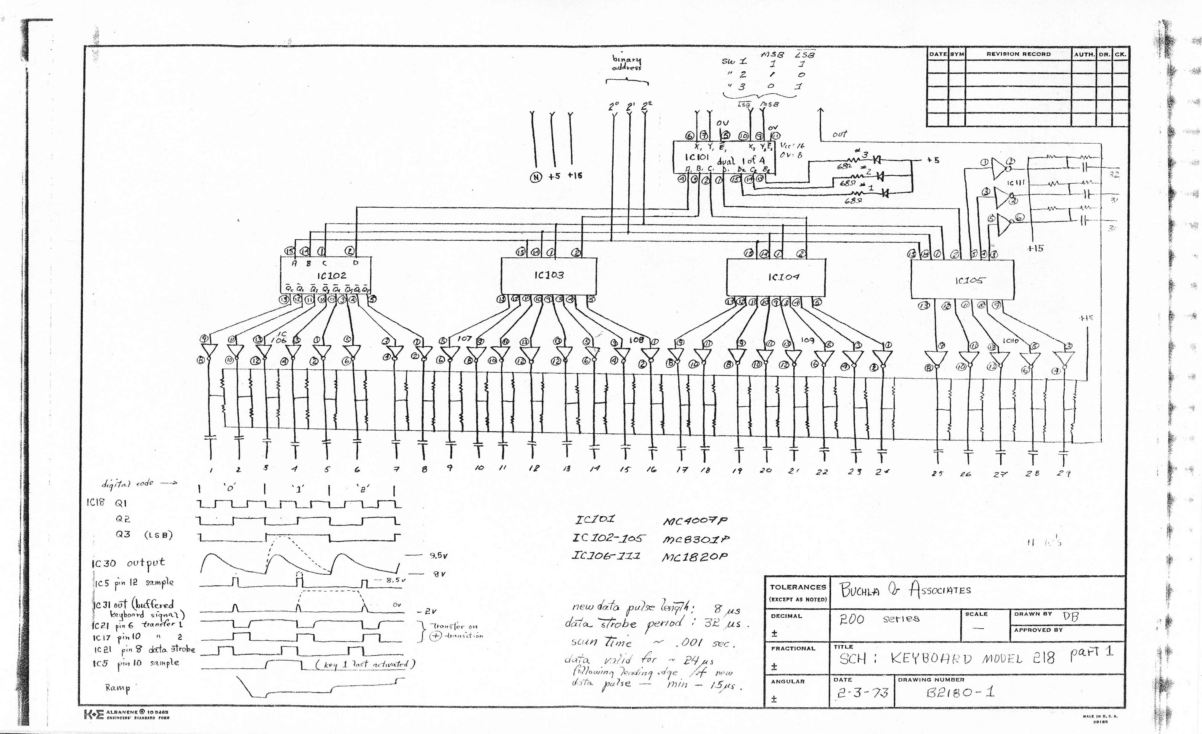

PostPosted: Sun Nov 16, 2008 3:25 pm    Post subject: Schematics Reply with quote  Mark this post and the followings unread
Forgot that I was gonna post them, but here they are.
218 Schem Page 1
 Filesize:  2.07 MB
 Viewed:  1726 Time(s)
Buchla 218 Page 2 Schem
 Filesize:  2.86 MB
 Viewed:  1530 Time(s)
Buchla 218 Board Part Placement
 Filesize:  2.2 MB
 Viewed:  1387 Time(s)
