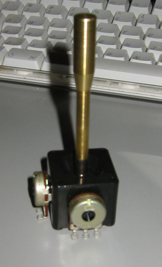

Actually the ones I bought were metric: M2.5 or M3. I'll take a look at the tap and check which. stay tuned.
heres a handle I machined from brass. its too heavy (won't stay where you leave it). I'm going to do another but hollow it out more. Aluminum would be better but all my panels are brass so....

I bought 10 joysticks of the same body type that Photon has the brass paddle in. MY big question, is building a 'centring' device FOR the paddle. Sad
On my dual joystick that I invented (photo of it, below - details on it posted in the Design section of my web page) requires something for both of the joysticks, as the joystick body up in the air, on top of the other one in the base, causes a lot of weight. The wiring from the top joystick also, causes a leaning.
(Having each of the 4 axii switchable on/off can take care of this but .....)
Anyone have any ideas for keeping a shaft centred?
hmm the one i bought a while back (not from this place) was 4-40- maybe they come both ways?
i guess you could use some small light springs configured in an x hooked to the bottom of the carriage-
maybe easier just to get an old self centering joystick off ebay or from a thrift store though.

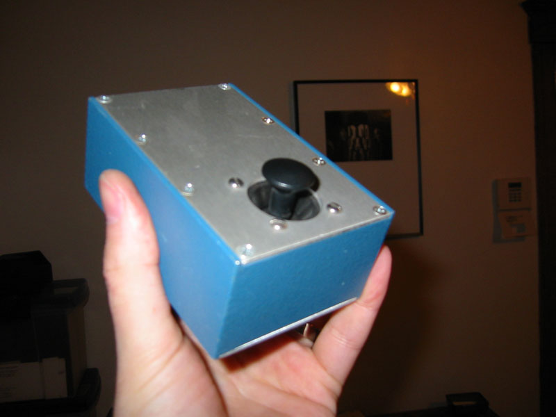

I checked and ones I had bought earlier were 4-40 and the more recent ones are M2.5
Being a salvage house, I guess they take what they can get. They (Alltronics) also sold a mushroom shaped press-on handle that fits either (see pic).

nice
is that a 7/8" hole?

Hi Ryk,
Depends upon the style how they are centered. I can't see yours clearly enough to be sure which technique to suggest.
But the most common means is to use two "paddles" shaped like the letters b and d. The holes go over the shaft that provides the pivot for the bail opposite the pot. The uprights of the b and d sit on either side of the bail, and there is a single spring going from one upright to the other.
There is a pin in the joystick housing just above the bail pivot so that as the bail moves the d leg, the b leg is stopped by the pin and the spring between them stretches providing the centering action. And vice versa.
It looks like your joysticks have metal bails? Copper, Brass, or phosphor bronze most likely. These usually didn't come with centering, but you probably could add it inexpensively if you're handy with metal or plastic fabrication. Sheet styrene or brass from a hobby store would be suitable.
The problem with using an "x" spring arrangement is that there is no hysteresis, so centering is weakest near the center and becomes unreliable. It also depends upon all 4 springs being equally stretched when you increase the tension to get past the lack of hysteresis. In short, it doesn't work very well.
Kind regards, Randal (Who used to fly R/C)
