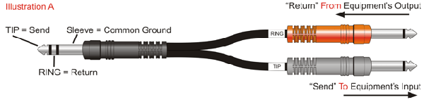

Quick question, if you don't mind -- is there a way to wire a normal stereo jack as an NC jack, so that I can do the send/return Clank/Clatter sections on the Clangora without buying new jacks? Little confused on this.
Sure, just wire your SEND signal to the jacks "TIP" and your RETURN signal to the jacks "SLEEVE" and use an insert cable like the one shown. When you are not using the insert path, place a shorted plug into the jack. A bit clumsy but it will work. YOU can use just one single shorting jack and use it like an insert and eliminate having to plug in a shorting plug. The jack will then make the connection for you when not in use. It's called "normalizing" the connection.

 Filesize:  20.92 KB

After digging around, I found some surplus stereo jacks I bought which have 5 lugs... so I can wire them with the NC option. Using a single jack wasn't an option, because I'd already finished drilling, painting and silkscreening the panel a few weeks ago. Wink
