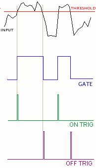

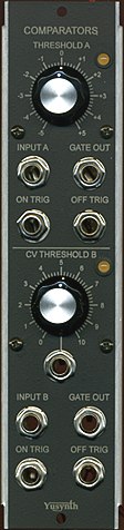

Here is a new YUSYNTH utility module.
It is a dual COMPARATOR module to create GATE signal and pulses from another source of signal. It can be used either to process modulation CVs or audio signal (though it's not a GATE extractor as it can be found with envelope followers).
Enjoy it at :
http://yusynth.net/Modular/EN/COMPARATORS/index.html

Looks great Yves! A really useful module, very nicely presented. And don't think I've seen an Off Trig before - seems like a great addition. Dual modules always rule, too (two.!.)

Very nice. Just curious, what would it sound like if you ran it audio frequencies?(if this is even possible). Some kind of wacky, pitch shifting PWM?

Well if you use the GATE OUT only it will sound just like PWM. Now if you combine the three outputs with an inverting/direct mixer and tweak the polarization (invert sign or direct) of the various signals I guess (I haven't tried it yet) you would obtain a mixture between PWM and SYNC effects. I'll give it a try...
