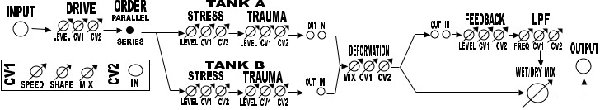

Im about to start building the neural agonizer and wanted to share some ideas i was pondering.
Im building the unit as a rackmount unit and want to build it as a standalone unit but also retain some of the modular features, since i plan on using this for recording but also my synth.
Mainly I want to add an onboard LFO, probably the Ken Stone utility LFO (since has a variable waveshape out) and have that normaled to all the CV inputs. So I can modulate parameters without having to have my synth connected to it.
Also maybe having a single alternate CV input that mults the single signal to all the CV mod inputs, instead of having to patch it in multiple points there will just be a level knob for each CV mod parameter (ie stress, trauma, etc)
Im not quite sure how to implement the ideas yet, just wanted to see what people thought. This Reverb seems pretty amazing and I really want to use it on other keyboards, guitars, maybe even vocals. Its also an incredibly flexible unit, the possibilities are endless!
Ill try to post a panel of my ideas and hopefully that will make more sense.

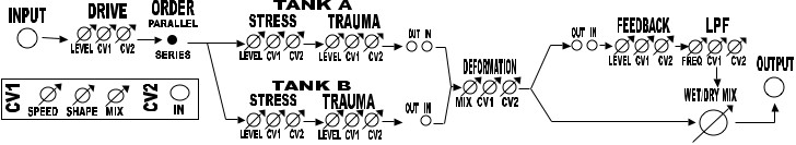

Im thinking something along these lines...

Brilliant idea I think. I have been AGONIZING over how to build this for sometime now. Mine is going into an old leather briefcase, with good bit of panel space left over with just the standard controls. I can vouch that the Utility LFO is a good one, as always I will suggest using a range switch.
After seeing you idea, I think I will now include a board I made of 4 clones of the MS20 LFO, again with range switching. Not sure if I should make it straight modular with patching, or use a rotary at each cv input for LFO 1/2/3/4/external.
I also intend to work out a way to install spring loaded buttons to null the springs physically, I have always found being able to massage the springs of a reverb to be very pleasing.
Thanks for the inspiration, I think I can see the finish line on this thing now.

Actually i might as well utilize both LFOs on the CGS utility LFO and maybe have a swtch to alternate between the onboard LFO or a patched in CV
