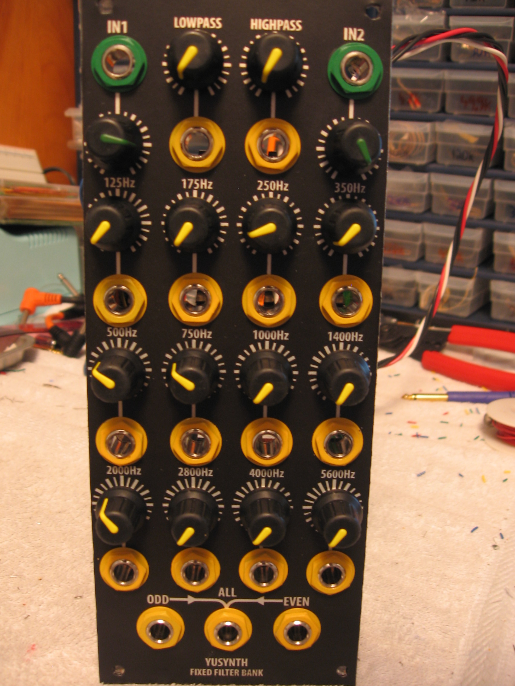

I have a question - I have the Bridechamber panel for the FFB and the input level pot is also labeled as dry-wet - could someone who has built this version (or Yves perhaps you know) how do you wire this exactly? Is it like this:
http://www.modularsynthesis.com/yusynth/DJB-FFB_schematic_mods.jpg
http://www.modularsynthesis.com/yusynth/DJB-FFB_mod_summary.jpg
Where the input pot's CCW lug has an extra wire that connects it to the
3 bypass throws on the active/bypass switch? I'm not sure how
this works out as a wet/dry mix control, then, since this throw won't
be connected to the outputs when the switch is in the active position. Also when the bypass switch is in "active" mode, then the dry input seems to be disconnected from the outputs. So it seems dry & wet are mutually exclusive settings/modes that can't be mixed given this wiring, so I'm thinking something different is required but I can't work out what.
Any help very much appreciated.

Hi
I am not responsible for this mod and from what I see on the mod schematics I have no problem to see how the bypass switches operate but I don't understand how the wet/dry pot would operate. What I see here is only a simple input level pot, not a balance pot between unprocessed and processed signal. Ask Scott Deyo what he had in mind when he designed the panel...
For such a wet/dry function here is what I would do : first I'd disconnect the ALL output jack from SW1A, then I'd connect the ALL output jack to the wiper lug of the pot, the CCW to the direct input and the CW to the center lug of SW1A. This mod in mid position would turn the FFB into a kind of equalizer (I think it's a boring mod)
I would also try a 470K lin pot for this rather than a 100K.

PostPosted: Sat Dec 05, 2009 10:56 pm    Post subject: Reply with quote  Mark this post and the followings unread
I just finished mine too. I love it! Many thanks. Very Happy
 Filesize:  773.88 KB
