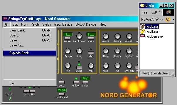

This shareware tool is only Windows based. Its best feature is the graphic interface: all the knobs are there. Pointing with the curser arrow on a knob reveals its value in the red figure in the down left corner. To copy this value (BTW Sending the whole Patch is easier Smile to the synth press [Shift+LFO1-Waveform] and turning the real knob shows the value in the LCD screen. But to see all parameter settings is a good thing of its own!
When receiving (NordGen SysEx has to be set to 'receive') a Program the Patch counter will rise to 2. It means there are two Programs loaded in the tool at that moment. Every new uploading in NordGen will increase that number. When saving all these Programs will be saved in that one and only file. After some time working this way I ended up creating files over 10 Mb big! And NordGen can't send Banks, only single Programs, BTW no Performances either: you'll have to use another way, like the sequencer method.
To avoid this strange behavior it's best to 'Explode' the 'Bank' in the folder in which NordGen is located (I always copy&paste the tool in the folder in the first place) The result of this explosion contains two files, one named nord0.ngf and the other one called nord1.ngf. The later one is the file you wanted to save, so delete nord0.ngf and rename the remaining file as you like. (I rename the suffix also from *.ngf into *.syx, because other Midi tools, like SendSysEx won't recognize *.ngf, which stands for NordGeneratorFile, of course)
How Explode look like...
