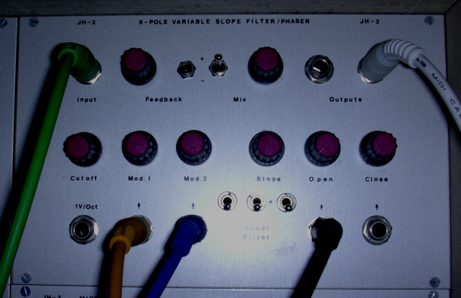

A mean little module from my JH-3 Modular.
6 filter poles, realzed with OTAs and combined FET / Bipolar buffer stages.
Variable Slope function for 6-pole VC LPF.
Voltage controlled Pole Spread for Phaser mode.
Zeroes switcahbel in pairs, i.e. a lot of combinations of all pass and low pass stages. Positive and negative feedback. Positive and negative wet/dry mix. Rather special overdrive behaviour (Dirty!), and (IMO) pleasant way of breaking into oscillation.
JH.

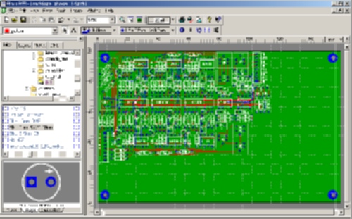

This one is fun to layout!
Finished the audio part.
Lots of space left on the board.
I will include a Noise + Sample & Hold Circuit, so you get these clocked random modulations without any outboard modules. Also, an on-board power supply, so this can become a stmp box as well as a modular synth module.
JH.
