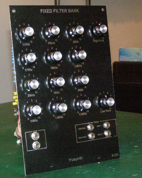

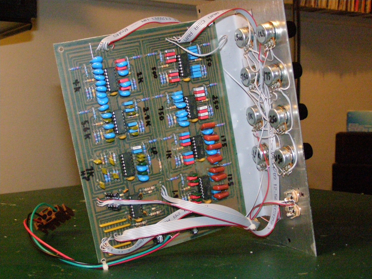

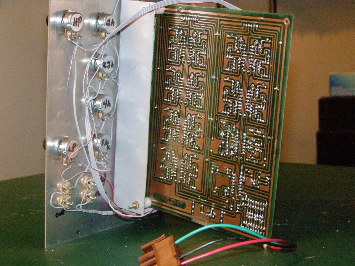

I finished this just before I left for the electro-music festival and I'm just now posting the pics.
I've felt for years that the Aries needed a Fixed Filter Bank and finally it has one.
View of the front panel. I layed out the knobs to occupy four columns to fit onto a double size (6"x9") panel.

Love those capacitors!

View of the etched side of the board.
