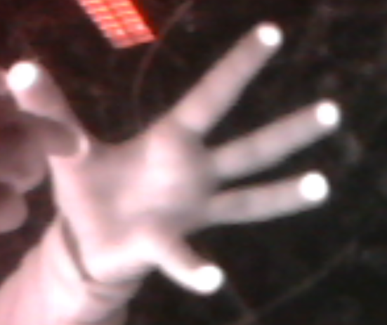

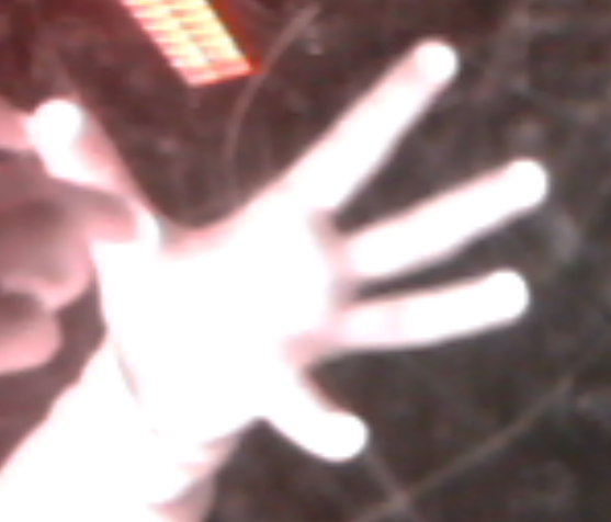

While we are on the subject... we did some initial testing of the principle, but I think something's wrong with the camera!
Look at these two pictures,
These are two frames from our test recording, the camera seems to have an auto-brightness function? Can somebody shed some light Very Happy on my problem..

What camera is it?

Logitech C200 webcam. I read the CCD could've been damaged through exposure, I hope that is a wild fairytale!

Looks like brightness and white level are automatic on that camera.

Any suggestions for a cheap webcam with manual focus and no auto brightness/white levels?
