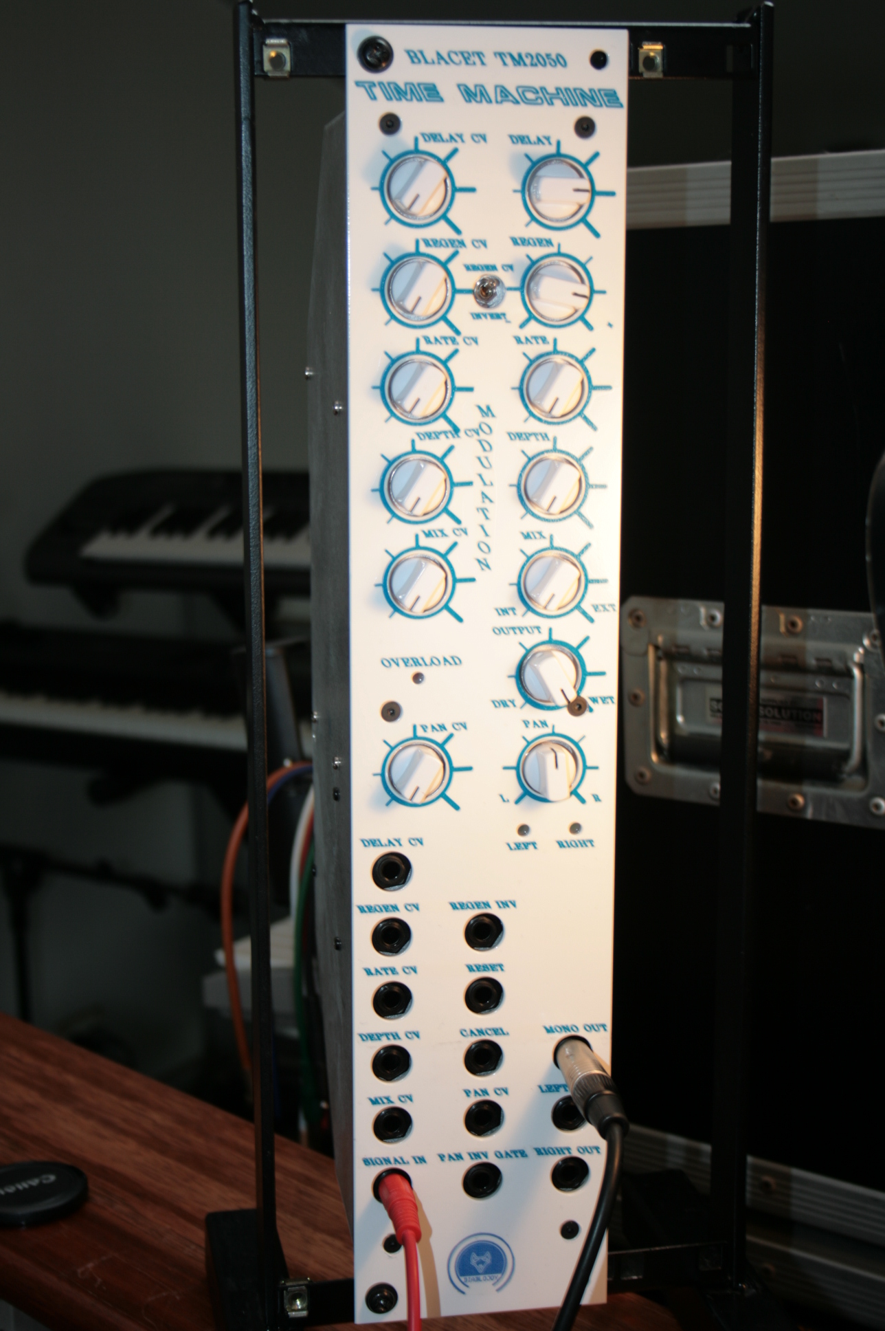

Smile finally finished my build of the time machine + some extra's
I'am reasonably happy with the end result so here's some pics

PostPosted: Sun Jun 26, 2011 6:28 am    Post subject: Reply with quote  Mark this post and the followings unread
Looks good!

What are the "extras" on the TM?
diablojoy
Posts: 809
Location: melbourne australia
PostPosted: Tue Jun 28, 2011 7:02 pm    Post subject: Reply with quote  Mark this post and the followings unread
CV attenuators on all Cv in jacks
added a vactrol pan cct taken from the wet signal
with a gated inverter in front so a straight positive CV signal
from a seq can be used to pan to additional left and right outputs
also another gated inverter is set up on the regen CV in
which is kind of nice to use on very short delays ala flanging
