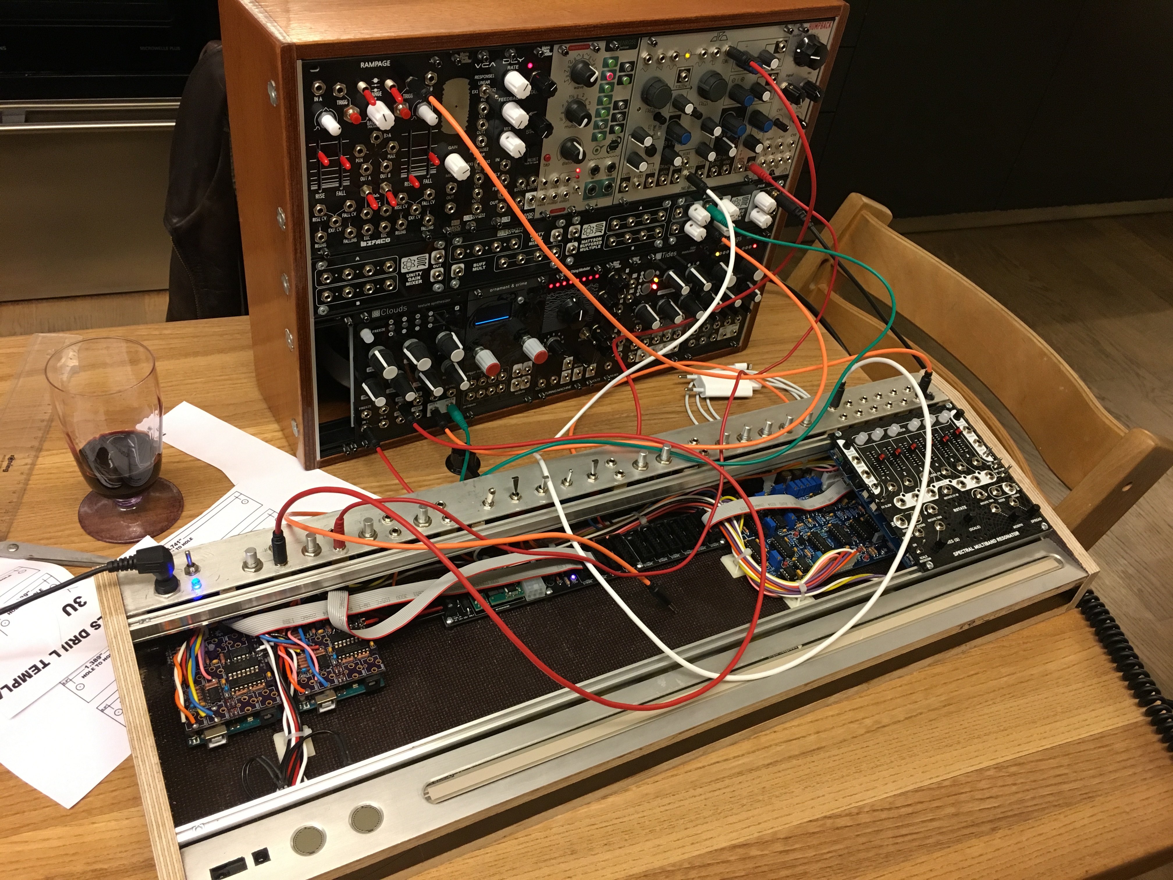

PostPosted: Tue Feb 13, 2018 10:44 am    Post subject: Reply with quote  Mark this post and the followings unread
Hey everybody,
First i'd like to say thanks a lot for this really cool project!
I just finished the appendage to use it as a controller for my eurorack and was trying to calibrate it, but ran into some problems while doing so.
I'm having troubles with point 3 in the calibration manual.
Everything works fine til step 3. 7., I get the -4.5 to -5V and also the +0.55 to 0.65 Volts.
But on TP1 I get really low values which aren't near right. When pressing the lowest point of the ribbon i get something like 0.009V and when pressing the highest point something like 0.014V.
I've already triplechecked my soldering, orientation of Diodes and IC's and everything and can't find anything wrong. Can anybody point me in the right direction as for where I should check for faults?
Oh, and I substituted the TS556 on U6 with this and a an Adapter: https://www.digikey.ch/product-detail/de/stmicroelectronics/TS556IDTTR/497-16000-1-ND/5452409
Is that alright?
I would be really thankful for some help as I already spent quite a lot of time for this and am so much looking forward to finishing it,
Till

tillibilli
Joined: Feb 13, 2018
Posts: 2
Location: Zürich Switzerland
PostPosted: Mon Feb 19, 2018 1:43 pm    Post subject: Reply with quote  Mark this post and the followings unread
Alright got the calibration sorted, switch soldered in the wrong way around ....
Here's my finished eurorack controller skiff version of it.
Also put in one long fsr under the softpot, two small fsr's and an IR sensor.
And two arduonos that read them and convert it to analog voltages.
Hope this sorts my controller needs out for quite some time.
Thanks again to the creators, it feels like an amazing instrument with so many capabilities!
 Filesize:  2.73 MB
 Viewed:  1468 Time(s)
