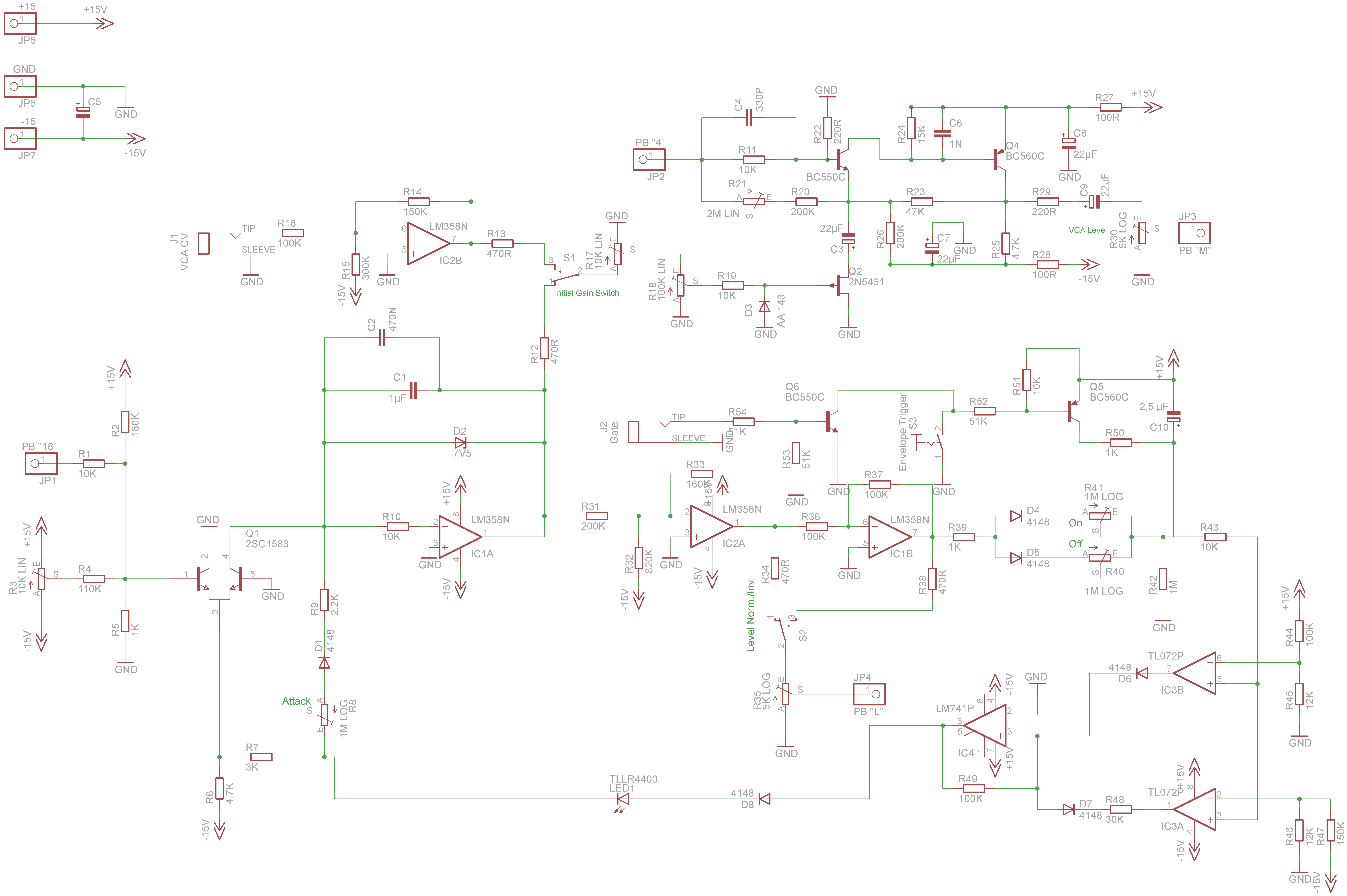

PostPosted: Fri Jun 08, 2012 12:23 pm    Post subject: 1st Board: Trapezoid Generator/VCA: Schematic completed Reply with quote  Mark this post and the followings unread
I finished the first Schematic: the Trapezoid Generator with the VCA.
 Filesize:  324.99 KB
 Viewed:  778 Time(s)
Fabian Baumanis
Joined: May 21, 2012
Posts: 12
PostPosted: Fri Jun 08, 2012 1:18 pm    Post subject: 1st Board: Trapezoid Generator/VCA: Board completed Reply with quote  Mark this post and the followings unread
Here is the brd-File of the Trapezoid/VCA.
It's single-sided, auto-route was'nt so successful, 93,1%.
So you have to solder some wires on the Top-Side.
Maybe someone can verify this PCB and optimize it.
Please give Feedback.
Stay Tuned.
Greets
Fabian Baumanis

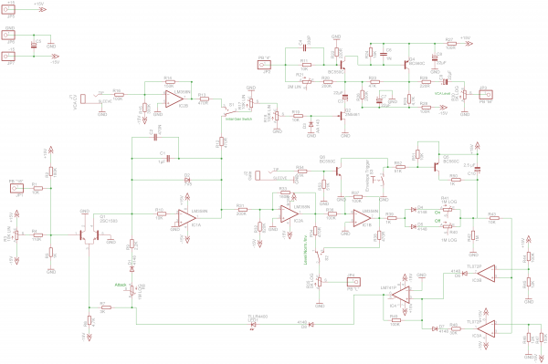

PostPosted: Sat Jun 09, 2012 12:50 am    Post subject: Board 2:Joystick - Schematic and brd completed Reply with quote  Mark this post and the followings unread
Hi Community,
i just finished the schematic and the brd for the Joystick-Board last night.
Auto-Route was 100%.
Please write some feedback.
Stay Tuned.
