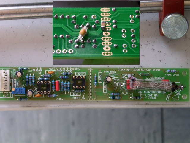

PostPosted: Mon Jan 31, 2011 6:37 am    Post subject: Reply with quote  Mark this post and the followings unread
hi,
anyone on modifying the inputs and outputs to use it with an ARP2600 (20Vpp) ?
espacially impedance issues ?

PostPosted: Wed Mar 30, 2011 12:39 am    Post subject: Reply with quote  Mark this post and the followings unread
hi mark,
i'm really glad you're around here cause i'm currently testing a CGS65 based on some of your modifications.
Thank you for sharing those !!!
about the ARP :
the signal voltage is 10Vpp
filter output is always +5Vmax, but can go beyond 10Vpp
(like +5 / -15V when you have all 5 input full)
same with the VCA
CV range is 10Vpp
envelloppe : 0 - +10V
althought the simple AR generates 0 - +8V max.
note : the preamp is really nasty and can go beyond 30Vpp (can't measure it exactly - my oscilloscope input is clipping)
so i think there's no need for modification on the voltages sides ?
for impedance, how you would mesure it ?

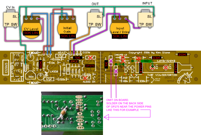

modifications :
i'm having trouble understanding the exact function of the LED's and diodes on the original circuit.
it doesn't sound the way it should. my two problems are :
the output of the CGS65 seems to be rectified (only positive side)
althought the output level is ok.
and i'm only having a usable range in the last 1/5 of the gain pot.
gain seem to low - can't get that "scream".
i'm going back with voltage measurements tonight or tomorow morning
P.S: really cool looking at the CGS65 waveshaping on the oscilloscope Wink

PostPosted: Wed Mar 30, 2011 4:13 am    Post subject: Reply with quote  Mark this post and the followings unread
It doesn't look like it. I adjusted mine so that the CV input and the Gain knob had the same range for a 0-5V envelope. Once you get it working you could adjust the resistor values for 8V or 10V.
Unless the ARP has an unusually high output impedance, or unusually low input impedance, it's a non-issue.
I replaced them with a resistor. I wouldn't recommend mixing my cathode circuit with the original.
Then I would trace the signal and see where that occurs. The output should not be single-sided.
Then you need to figure out whether it is a problem with the CV circuit, or the audio circuit. I haven't looked at this thing in a long time, so I don't remember what the voltage range was on the control grid. Perhaps you have the offset voltage set too high, and you are burying most of the CV range? Regardless, the CV circuit is very simple. So I would trace the DC voltages to see if it is working properly. Check the voltages on pin 7 and pin 6, and pins 2 and 1, and that they are working as inverted amplifiers.
Also which op-amp did you use?
bassculture
Joined: Jan 23, 2011
Posts: 22
Location: france
PostPosted: Wed Mar 30, 2011 7:34 am    Post subject: Reply with quote  Mark this post and the followings unread
hi !
ok, i correct my mistake (i didn't removed the 2 4041 diodes)
also the initial CV trimmer was set too low.
now everything seems to work ok.
but the gain range is stil at the end of the pot curve (linear pot)
so this the modifications i take from your first post :
i just take the leds and 1,5K and diodes and replaced them with 1,2K
i will add the 47uF cap with a switch also
i modified the inputs, outputs and bias switch like will and dave do :
http://www.dragonflyalley.com/constructionCGS65tubeVCA.htm
they stick to the MOTM format which has the same voltage as the ARP
(i hope i get everything right)
in fact the gain pot is acting like a fixed CV level ?
the real "tone shaper" is the input pot.
now i'm wondering how to get a CV to control the input level
do you have any tips on how achieving this with a few components more ?
or maybe that would be better messing mith the "quality / gain" resistor
(i have 8K2 in place - but thinking about soldering a pot in there)
plugging a CV in an audio input is a great sounding option to get around this, but not the same Wink
kind of a messy post, but any thought from an expert like you will be appreciated Wink
thanks for sharing !

PostPosted: Wed Mar 30, 2011 7:55 am    Post subject: Reply with quote  Mark this post and the followings unread
That's good.
Are we talking about the Gain/CV pot or the input pot? You might prefer an audio taper for the audio inputs. I used linear because that's what I had.
You mean the cathode cap? I wouldn't use a switch because the wiring will do two things you don't want -- add an antenna, and add impedance. And I don't see a point in being able to switch it on and off. Do make sure it is on the correct side, and you use a heater resistor that can handle the current. I used a 1/2W.

I installed most Mods today (no bias switch, left that like the original schematic):
PrimateSynthesis wrote:
Here are some pictures showing the grid bias wiring and cathode bypass modifications.
I'm a bit confused as you said you omitted the 47 pF caps although they are still on the pics.
Unfortunately I forgot to add heat shrink tube before installing the tube but the distances between the wire looks still OK.
I've attached a pic of my PCB including a pic of the back with the 100Ns caps for the OP275. I used one 1206 SMD cap as there is a gap between ground and V- where it fits exactly and used an axial ceramic cap between ground and V+.
Used a 51K instead of a 50K/49K9 for the CV input because I had that at hand and guessed 1K doesn't make much difference (my DMM measured 50K9).
Plus I've compiled the Mods I installed into the original schematic because it's easier to compare this way. Attached that, too. I hope I didn't miss anything besides the bias switch which I omitted on purpose as I want to use it for dirty stuff anyway and don't need a clean position (I guess).
PCB stuffed with PrimateSynthesis Mods
 Filesize:  80.33 KB
 Viewed:  446 Time(s)
Compiled PrimateSynthesis Mods without the bias switch (Edit: Corrected the position of the 47uF)
 Filesize:  59.6 KB
 Viewed:  645 Time(s)

Finished my first modded Tube VCA:
http://electro-music.com/forum/post-363929.html#363929
So the mods as described in my schematic picture are definitely working.
Nice, thanks for the schematic and everything. I'm just building some and want to try these mods. Just one question - did you use 50K pots or 100K? because on your modded schematic you left them marked as 100K (only one log changed to linear), but in the PDF the autor said he used 50K linear Bourbon for all pots, so now i'm not sure if i should use 50k or 100k.
To make sure that I won't get confused and mess up something, I redrawed the changes from the schematic onto a PCB picture from ken's site. Uploading here as well...will perhaps save some time to somebody. Just beware that I have not built/tested it using that picture.
 Filesize:  232.92 KB
 Viewed:  436 Time(s)
sonicwarrior
Joined: Dec 22, 2005
Posts: 266
Location: Cologne, Germany
PostPosted: Sun Aug 26, 2012 2:02 pm    Post subject: Reply with quote  Mark this post and the followings unread
On the last one (the other one is screwed in place and I was too lazy to look at that one too) I used 50K pots. But as these are just voltage dividers or attenuators it won't make a difference here.
Your drawing looks good at first sight but you are missing the bias jumper. The PCB image doesn't show the current Rev 1.1 PCB because the different bias possibilities are not on it.
Aum Generator
Joined: Aug 15, 2011
Posts: 11
Location: Bratislava
PostPosted: Sun Aug 26, 2012 2:12 pm    Post subject: Reply with quote  Mark this post and the followings unread
thanks
i was also missing the 50k instead of 100k on CV in. corrected.
the pcb picture on ken's site is different than pcb. when placing the 47uF i had to draw pads nearby the tube's pads, because they were not on the picture.
going to check info about the bias jumper in PDF. Only thing i see on the schematic and not on my picture is that BLUE/PURPLE arrow. Is it that?
