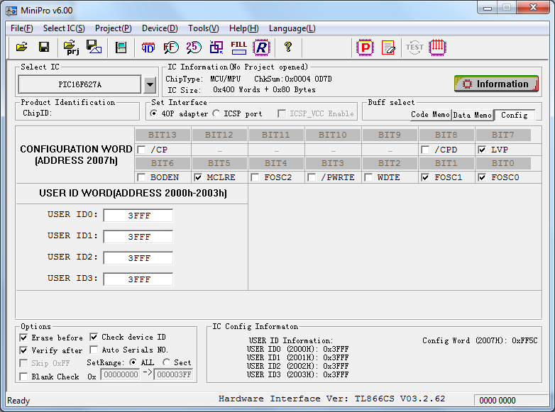

PostPosted: Tue Nov 03, 2015 3:17 pm    Post subject: Reply with quote  Mark this post and the followings unread
Digging up this ancient thread to mention that I was able to successfully burn the ACX Quantizer using the current firmware posted on the ACX site.
I had to mess around with the fuse settings which were incorrect.
Here's what worked with my crappy K150 USB programmer using MicroPro in Windows:

PostPosted: Sun Nov 15, 2015 9:14 am    Post subject: tl866a Reply with quote  Mark this post and the followings unread
Hi Everybody,
I have built up a board based on the hexinverter schematic , downloaded the firmware HEX file file.
but i cannot get the pic programmed with the TL855 programmer.
it says its programmed but doesnt work.
Can anyone here help ?
Thanks , Lee

PostPosted: Sun Nov 15, 2015 5:08 pm    Post subject: Reply with quote  Mark this post and the followings unread
braincell - make sure the configuration bits (aka fuses) match the ones in the image I posted above.
Sneak-Thief - raw electrofunk

sneakthief
Joined: Jul 24, 2006
Posts: 569
Location: Berlin
PostPosted: Mon Nov 16, 2015 5:46 am    Post subject: Reply with quote  Mark this post and the followings unread
Lee: pic chips are almost always programmed with HEX files.
In your programmer software, check the configuration bits page - it looks something like this picture I found on the net:
And make sure the bits are set to the ones I used and posted in my earlier post: http://electro-music.com/forum/post-414216.html#414216
(and not the ones in this picture in this post!!)
