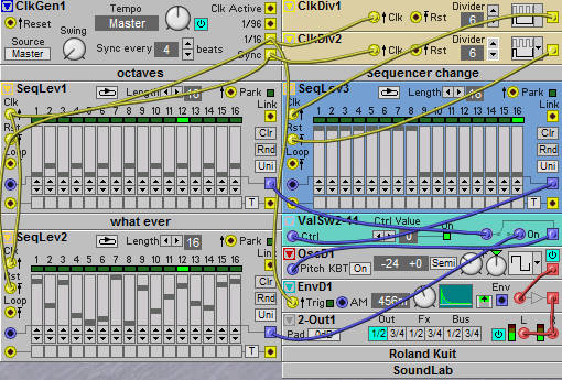

Hej Guys,
Maybe a silly question, but hard to find the answer alone.
How can i transcribe this (from 3/27 to the end) ?
http://www.youtube.com/watch?v=njJaMb1e50I&playnext=1&list=PLAA2ECBDE6C2C9378&feature=results_main
If you watch and listen carefully, you can see that the first part of the video is : one hit of the tom = one change of bass drum and snare drum sequence.
At the end, from 3/27 to the end, when he hits his tom, you can listen the octave of the bass drum + the melodia from his snare.
BUT when he hits his snare dum, he sounds like a normal snare, no notes.
I was thinking about a Clk Gen linked to all y snare sequencers / or logic gates.
Ideas ?

It's like i've full of sequencers note in all y slots, and sometimes i would like that some of these play twice.
So in a "live" situation, it's like only one element can play two sequencers at the time, and not one like i already do.
Where is the trick ?

H Tip Tap,
Here is a patch which can bring you further.
Here the Sequencers are triggered by a clock module. You can trigger these by the audio in triggers mentioned before. The 3rd sequencer makes the switch.

Yeaahhh !
I moved the clk gen and put the audio in trigger discussed before, works fine.
I've just put into the fx area some sequencers. So into the VA there is the famous octaves, and in fx area the main theme of the song. Such this way it's working.
I tried to put more seq.
How now can i chain these sequencers to have more with this way of controlling ? Every time i try i don't see that.

All those questions Tip Tap.
You have my book. Just read the chapter Dance-Techno II for chaining Sequencers. 3rd patch!
