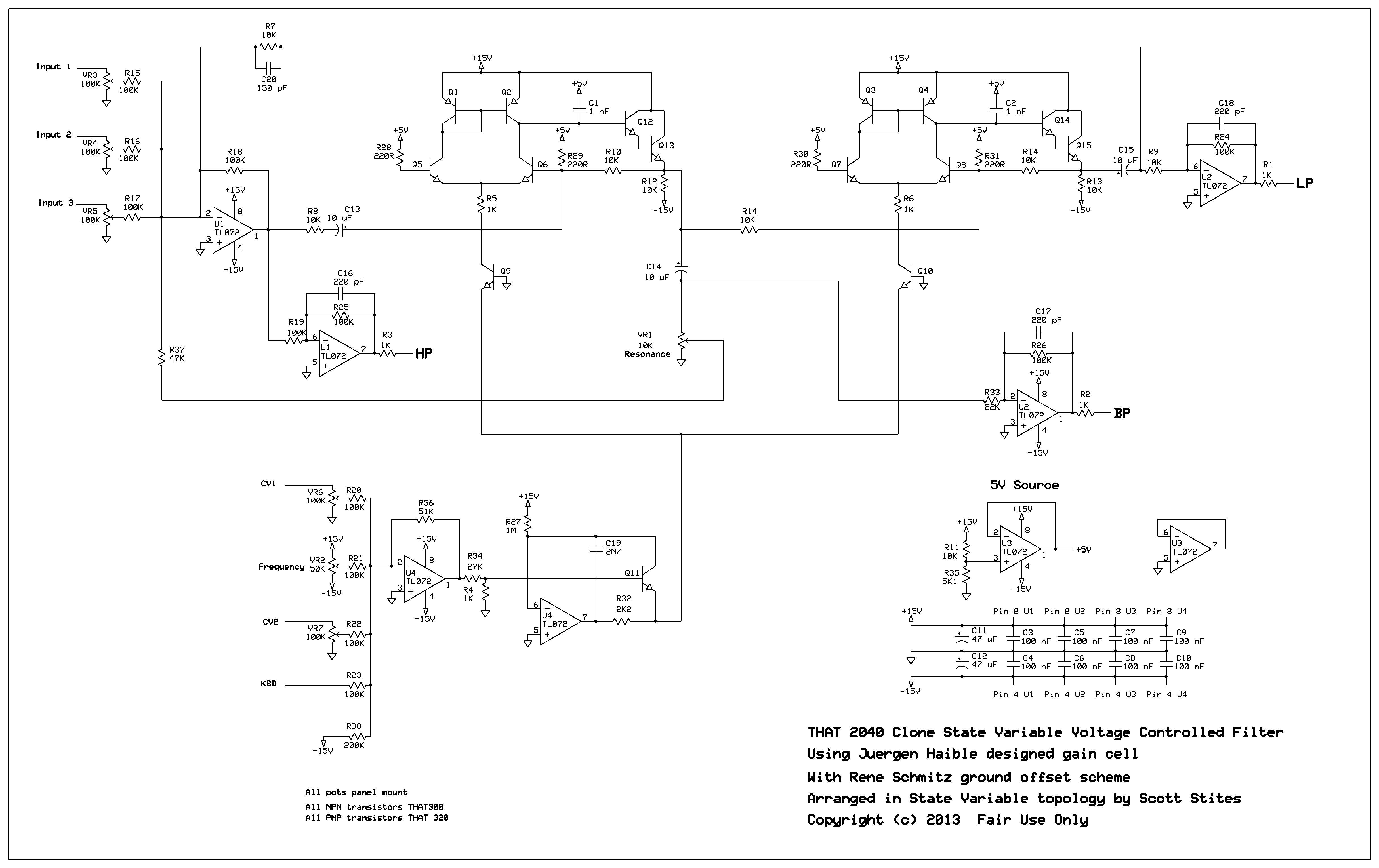

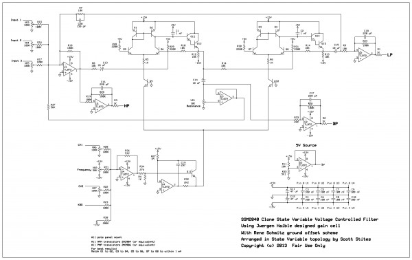

I guess it's been a while since I posted anything of any interest. Hopefully this may be to someone. Like any synth DIYer, I have a number of circuits that have fallen to the wayside - some for good reason, others because I started chasing after a brand new shiny.
A long time ago, when TH was developing the Mankato filter, I became interested in the 2040. Romeo Fahl told me that one design of the original 2040 filter that really kicked butt was the state variable configuration of the chip. I recall him saying that it was so thick, you could drink it with a straw or something like that. For a few years the idea kicked around in my head to try JH's 2040 gain cell in that configuration - if I could figure it out. I think I did figure it out. Well - I figured out something anyway that LP, BP and HP outputs. And, yes, it was much thicker than any OTA variant of the SVVCF I'd tried out. Much thicker. It really was a monster.
I remember sending the schematic to both JH and Rene Schmitz, because I'd cobbed elements from both of them. I don't think I ever heard back from Rene, but JH's comment was mainly "How come you are buffering the resonance". I loved that guy. Anyway, I had no good answer other than the fact that I had that op amp stage free, so....
Anyway, I did two variants of it: one used 2N3904s and 2N3906s, and the other I used THAT parts on. TBH, I don't think there was enough difference between the two to justify the cost of the THAT transistors, but they do make it somewhat easier to build. You'll notice on that schematic I took JH's advice, though it doesn't make any difference other than not look quite so ludicrous. You could use that stage, I suppose, to produce a notch output.
So, I submit to anyone interested the two versions of the 2040 Transistor State Variable Filter. I imagine, if you're successful, you will find that it is a far more...aggressive...filter than your OTA SVVCF. By far.
I've attached two samples I made of the filter - both were the discrete version (2N3904 and 2N3906). This same version was the filter I used in this video - you'll see a shot of it on the breadboard as the video starts.

EDIT: Replaced schematics with versions that fixed erroneous bypass cap values.
THAT Transistor Version (fixed bypass cap values)

Discrete Version (bypass cap values corrected)

How can you tell how well they are matched? I looked up the datasheet and did not see that information.
Scott Stites
Joined: Dec 23, 2005
Posts: 4127
Location: Mount Hope, KS USA
Audio files: 96
PostPosted: Tue Apr 09, 2013 5:44 am    Post subject: Reply with quote  Mark this post and the followings unread
Hey Delayed,
Do you mean the THAT parts? They're matched to 500 uV, if they're of the same gender (PNP or NPN). The discrete parts can be hand-matched. Actually, you can get pretty good initial results even if you don't match them.
I did make one small change to the discrete version that shows up in the 2040 version - the 150 pF cap across R7. IIRC, that fixed a problem with the resonance getting some interference at high levels. It's on this attached version I drew up a couple of days after the one above.

If delayed is referring to the BC847bs parts I mentioned, no reference to the degree of matching is mentioned in the datasheet. I believe "L-1" on the muffwiggler forum checked a few and came to good results. I have used them but not checked them for matching.
However, the BCM847bs is a matched dual and that does have the mismatch mentioned in the datasheet, the dual PNP part is BCM857bs.
For even more weirdedness, there's a NPN-PNP dual available as well, the BC847pn.

I was actually thinking of making a version of JHs discrete 2040 circuit, but its a bit (well ok, lots) over my head.
Im trying to work out how best to build using THAT chips, of which i have a few; In terms of the matching, which ones are critical? I guess Q1-Q8 are, can the rest be 2n390x ? But could be wildly wrong.

@Diablojoy It'll be interesting to see what you come up with for a board.
@LF Lab: Rene's 2040 design was actually for surface mount - this could turn into a very tiny filter, I imagine, if you went all surface mount.
@Paradigm: Yeah - you could use 2N3904's with the THAT part. You might want to compare yourself, but generally if you get your parts from the same lot, the matching these days would likely be quite good enough for this filter already. I seem to recall Rene telling me that he didn't bother too much with matching on his filter.
@Elmegil: Any color you choose Smile. Generally when I do stuff like this, I start off with dual op amps because I may choose later on to put better quality audio op amps in, and the better quality DIP op amps I prefer are usually dual op amps; rarely are they in quad (I'm rather enamored with the OPA2134). Another reason is I like to keep the control portion separate from the audio portion. But, that's just me, and it probably wouldn't make a lick of difference how you select and arrange them.

That's probably a good idea not to use it as an oscillator - IIRC, it doesn't self-oscillate, but, heck, it's been five years.
I noticed I still have my THAT version on breadboard. It's a bit squashed, but I'll have to see if it works this weekend.

Paradigm, actually I should have mentioned the self-oscillation. I'm fairly sure it didn't self-oscillate back when I was playing with it, but I should check that again. Dang, I've played with so many filters through the years, they're starting to run together in my brain Very Happy.
And you're right - most filters will self-oscillate. Seems to me I've played with a couple of SVVCFs that didn't, but one I do know that oscillates like a bat out of hell is Ray Wilson's SVVCF.

Another basic query, all the bypass caps are shown as 0.1nF, i thought 0.1uF was more common? Any reason for this?

The reason would be my brain. 0.1 uF would be the correct value. I'll fix that when I can - I'm writing this from work. Our crude rural internet service is down because of an ice storm.

Fixed'em.
