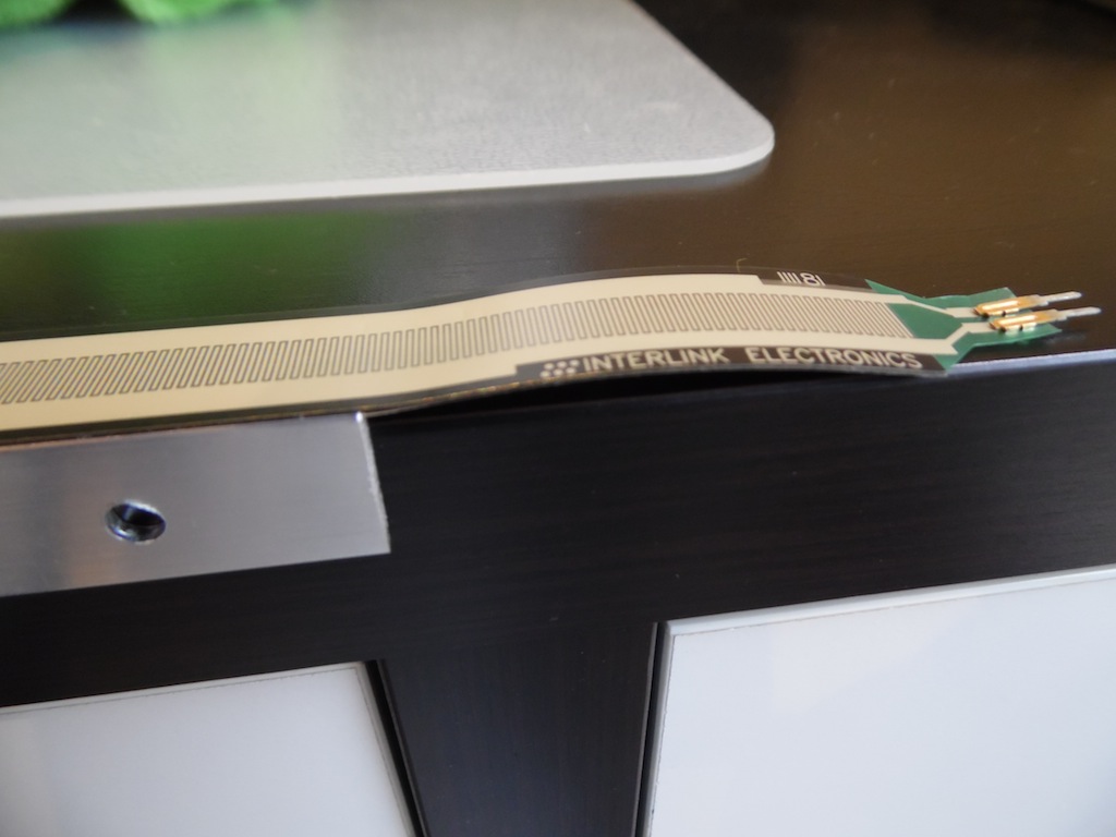

I've had a long Interlink FSR laying around for ages, so I thought I'd do something with it... and share.
I decided to add LFO aftertouch to my MKIII Odyssey (I'll probably get round to different routing configurations later).
Cost - Under £20!!
What you need:
A Long Interlink FSR (620mm x 15mm)
Aluminium Angle (15mm x 565mm)
Self Adhesive Neoprene rubber strip (3mm x 15mm)
Nuts, bolts, washers for mounting.
What to do:
Drill a 4mm hole halfway up the alu angle, and 20mm in from the left and right edge (See pic 1)
CAREFULLY remove the keybed from the Odyssey and drill matching holes (15mm up from the bottom "lip")
Clean the top of the alu angle with isopropyl alcohol to remove any grease etc and attach the (self adhesive) FSR - Note the orientation in pic 2.
Apply the 3mm thick neoprene strip to the top of the FSR, and cut to match the length of the alu angle as in pic 3.
Bolt the FSR assembly to the ARP keybed and see if the rectangular key stop JUST rests on the neoprene when depressed - you can get away with a very slight gap, but you may have to file the hole in the angle to allow adjustment... I got plain lucky Smile
Put the keybed back in the Odyssey
Put two flying leads onto the FSR (how you go about this is up to you, but I soldered an 8 pin DIL socket onto some vero board, took the flying leads off pins 1 & 2 and just inserted the end of the FSR into the DIL socket (it's nice and tight). You'll need to CAREFULLY bend the end of the FSR round as there's not much room there!
Solder one lead to the LFO output (you'll see a single connector on the lower middle PCB with a GREEN wire going to PCB 1 - that's the LFO out). Solder the other lead to the track where the WHITE wire of the PPC connector is - top of PCB 1.
Close the panel, fire up - Hey Presto, LFO modulation via aftertouch.
As I mentioned earlier, you may need to adjust the hight of the FSR to suit.
The whole thing took just over an hour to make and install - It helps if you get everything ready in advance... coffee, relaxing music, a lock on the door... Wink
