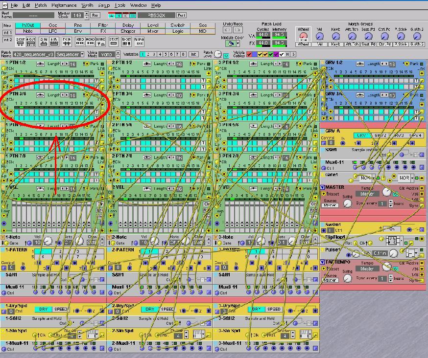

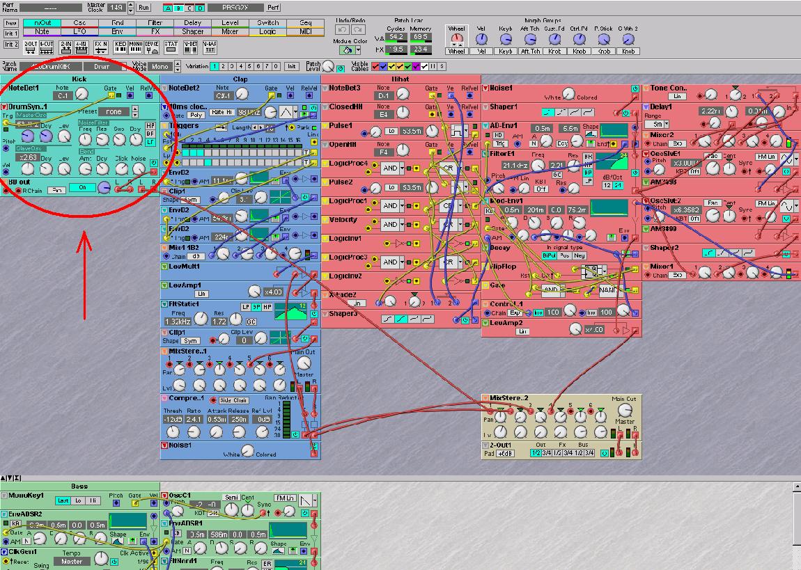

Subject description: random swing on a rolling kick -but work good if you select another slot
Into this .prf, I use 2 patch.
Slot 1 : Step sequencer to trigger the kick (and other drums) on slot 2
Slot 2 : Kick, (Clap, HiHat and Bass)
The swing seem to be alterate. This is not consistent and very precise. BUT, the sequence play normal when I select another slot or "Patch Settings" or "Global Panel" or "System/Patch". I use the Master mode.
With the patch :
1. Be careful with the volume (Master Level). The kick sound is on 1/16th. 145 BPM. This is a rolling loop (BBBRRrrrrrr).
2. Load the patch
3. Listen (the groove is affected)
4. Select another slot or push "Patch Settings" or "Global Panel" or "System/Patch".
5, Listen (the groove play normal)
The kick (slot 2) is triggered by the module "1 PTN 3/4" (slot 1). It seem more I use many sequencers into a slot, more the problem is big.
When I look all big patch from you in the archive I will push "Patch Settings" or "Global Panel" or "System/Patch" before now. Or the result can be alterate. Is it a bug ? To me it does not make sense that the groove does not seem stable when I'm on the slot I worked on but it's accurate when I chose a different menu.
This is not a problem about VCO sync/phase or an EQ before a filter (click, glitch, aliasing). I use the DrumSynth in the exemple bellow for the kick sound.

I edited my first post after doing some tests to be more accurate, and I've added screen captures from the editor.
