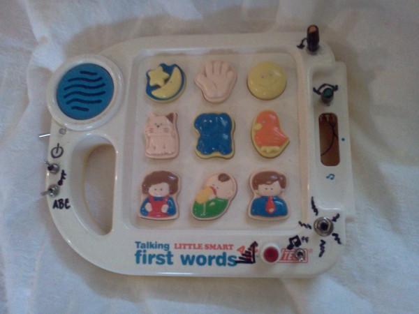

I have been bending a few toys here and there. My 1st toy I fried unfortunately. It was a cool little Casio PT-80. Outside of that, I have done a few newer toy on which I could only find places to add pitch pots. They only toy I have completed was a V-Tech 1st Words. Fun little toy. All just pots, switches, and buttons.
I am about to start my Speak & Math and think I may want to add some body contacts to it. What are some good things to use for body contacts?
Thanks
B
