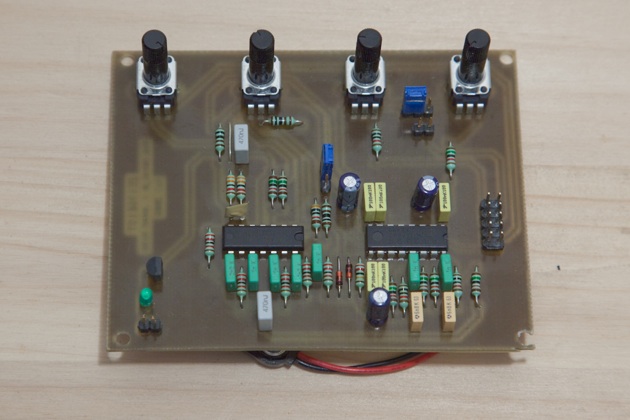

I asked for the Zeitgeist schematics, but....
Edit: I just remembered Rob mailed them to me. As he also posted the Benjolin schematics I presume he won't mind me posting the Zeitgeist.

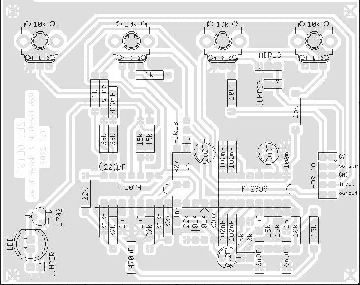

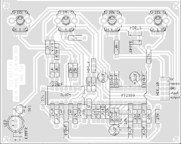

PostPosted: Mon Jul 04, 2011 12:59 pm    Post subject: This May be a stupid question but...... Reply with quote  Mark this post and the followings unread
How can you use the board graphic for making a pcb when it's got the component graphics on it like that?
Thanks

I noticed a small error on the schematic diagram. It has C9 - pin 9 on the delay chip - as 9100nF. Looking at the overlay and photo here it appears that the extra 9 is a typo, it should probably be 100nF.

PostPosted: Fri Mar 16, 2012 10:43 am    Post subject: Seriously Reply with quote  Mark this post and the followings unread
On the Benjolin post there is a graphic with the components and a graphic for using a transfer with no components to print on the transfer paper.
Is there something I'm missing?
Please tell me.
Thanks

This might be sacrilege, but I'm currently working on an alternate PCB layout for the Zeitgeist with external pots and jacks. Here's an image. Not making it fully available yet, as I haven't had the time to confirm that it's working perfectly.
http://imgur.com/1TLzkLx

Hi can anyone tell me what these potentiometers on Rob's board is called? I often need ones this size!
And can anyone explain the 10 pin connector for the jumper if I wanted to make one myself?

PostPosted: Sun Jun 02, 2013 1:43 am    Post subject: Reply with quote  Mark this post and the followings unread
Those are 9mm pots, several manufacturers make them, Alpha too.
Just need to specify that you want vertical mount.

PostPosted: Tue Jun 11, 2013 12:20 am    Post subject: n00b question Reply with quote  Mark this post and the followings unread
What exactly are the components labeled "HDR_3"? I recognize everything else and have most of it on hand, but I've never seen these before. Are they some type of transistor?
inlifeindeath
Joined: Apr 02, 2010
Posts: 316
Location: Albuquerque, NM
PostPosted: Tue Jun 11, 2013 9:25 am    Post subject: Reply with quote  Mark this post and the followings unread
They are headers, you can just use hookup wire.

ehm.....anybody has the pnp transfer file for the pcb on the first post here??

PostPosted: Tue Apr 21, 2015 3:23 am    Post subject: Re: Zeitgeist Schematics Reply with quote  Mark this post and the followings unread
sorry to push again, but if Rob sent u the files to build your own Zeitgeist....why u posted only schematics and parts placement and no layout for pnp transfer??...It's like an invitation for dinner with no food on the table.... Shocked

PostPosted: Tue Apr 21, 2015 10:02 am    Post subject: Re: Zeitgeist Schematics Reply with quote  Mark this post and the followings unread
tokyomatik wrote:
it's not hard to edit the posted jpg to remove the parts outline and leave just the copper. this is DIY, afterall Laughing

PostPosted: Thu May 07, 2015 5:33 pm    Post subject: Reply with quote  Mark this post and the followings unread
I'm checking the board with the components and I have some questions:
what are the pots function names?? (from left to right)
the CV input is to control the delay time?
what is SENSOR doing?(HDR 10)
what are the functions of JUMPER and the two HDR 3? jumpers for a different settings ?
the JUMPER next to the led says + and -, should I consider - as Ground??
I will try to etch this board in these days, not so many parts and looks also an easy build...any recomendation?
