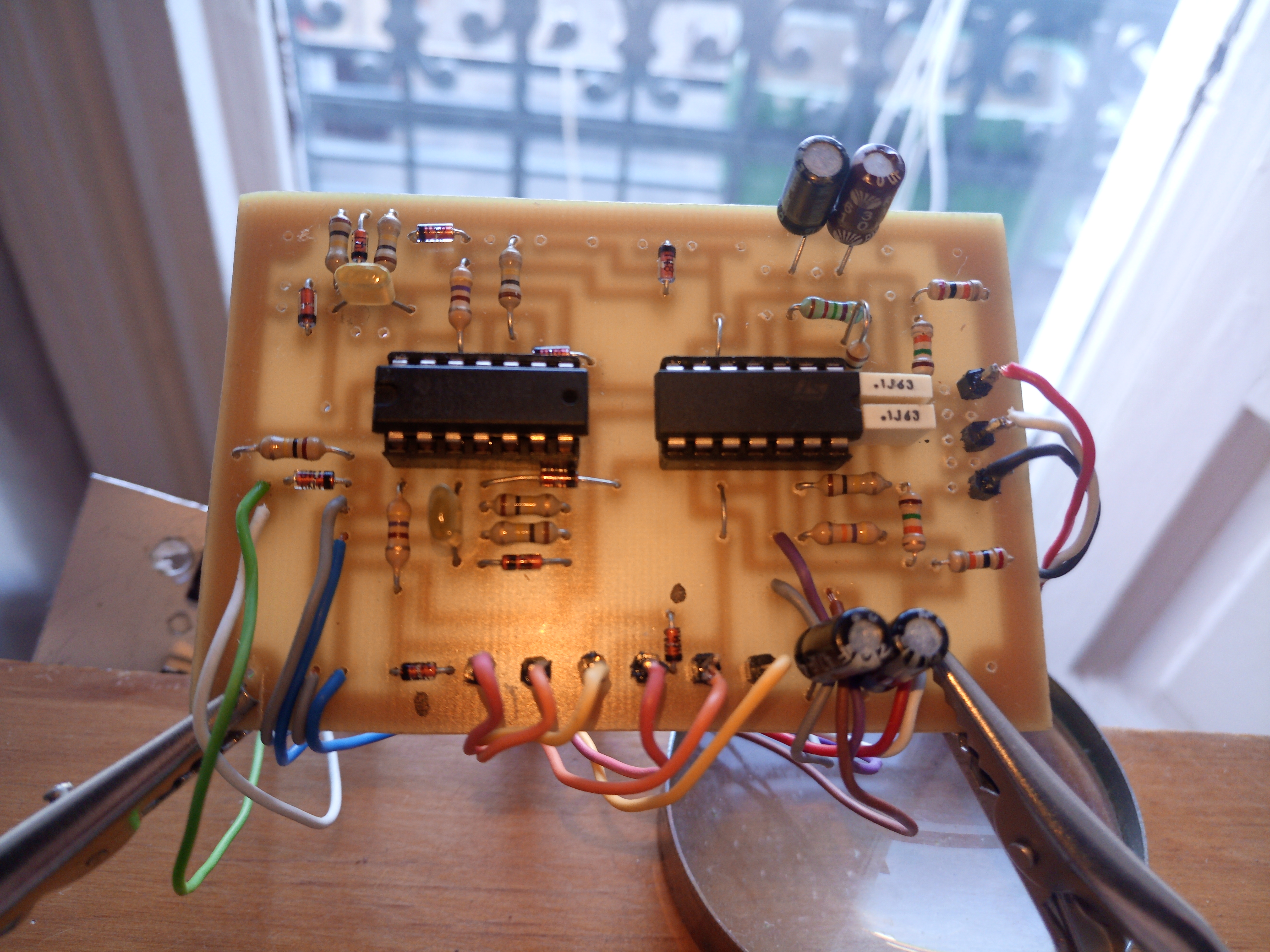

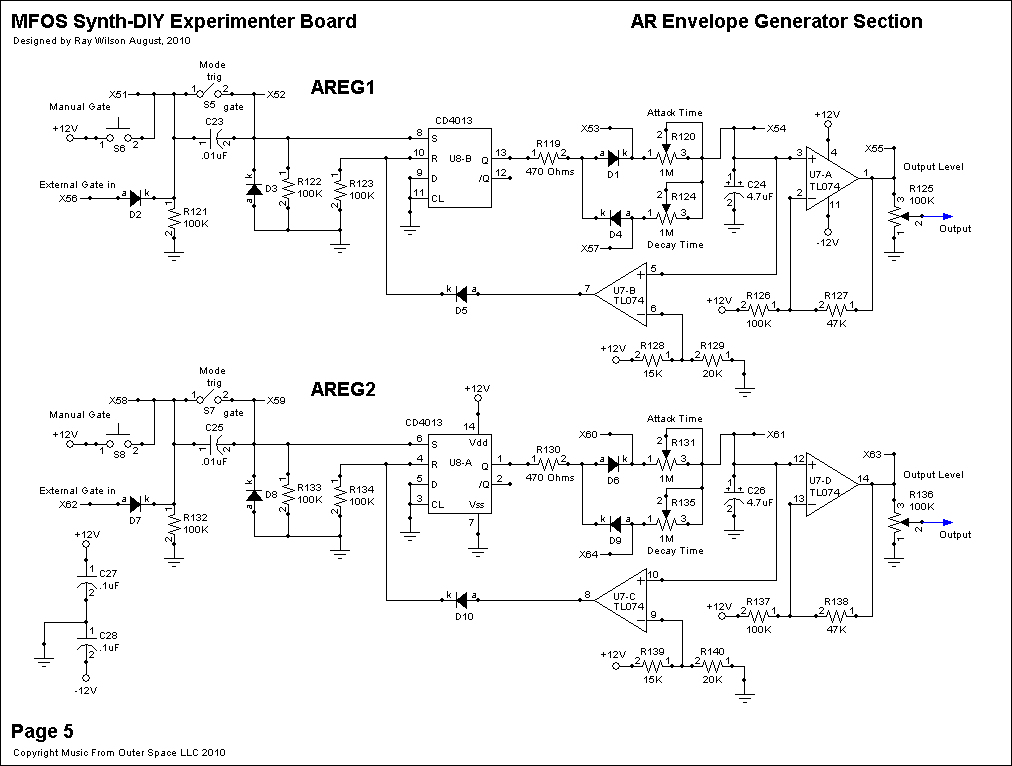

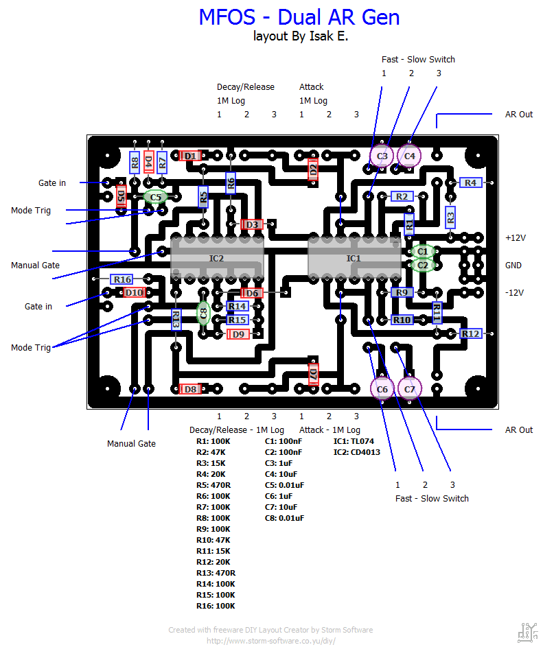

Hi Guys
just finished the dual AR from MFOS synth diy experiment board shceme.
its not verified yet and hope to do it soon.
i did mods for possibility to have fast or slow AR.
i replaced C24 and C26 (4.7uF) to 1uF and 10uF with a switch.
you can see it in the next pic.
i removed the 100k output pots, you can attenuate at the input of the other module you connecting it to.
i built this AR Gen on stripboard when C24 is 4.7uF you can watch the Tube Vid in the next link http://www.youtube.com/watch?v=Ep36ZKTA8jc (move to 3:55)
i'm sorry that the vid is in Hebrew but i dont have any other way to show you how the AR Gen is operating.
if you making this please let me/us know its working ok.
NOTES:
1 - there are 2 jumpers, dont forget them.
2 - all diodes are 1N914 or 1N4148.
3 - it runs on 12V and i think there will be no problem to run it with 15V with no mods.
Isak E.

PostPosted: Wed May 08, 2019 2:59 pm    Post subject: Layout not working Reply with quote  Mark this post and the followings unread
Hello isak, your Layout is tested and not working, I did a pcb but does not work Sad
isak
Joined: Dec 13, 2009
Posts: 847
Location: Israel
Audio files: 18
PostPosted: Wed May 08, 2019 11:11 pm    Post subject: Re: Layout not working Reply with quote  Mark this post and the followings unread
Hi there.
Well, it works for me.
I build more than few Smile .
If its not working for you, start checking the V in your circuit, make sure all the IC's gets the V they need.
Than make sure all the components are the correct ones and well oriented (caps, diodes efc).
Isak.
Alfredo
Joined: Nov 20, 2008
Posts: 52
Location: Spain
PostPosted: Sun May 12, 2019 4:33 pm    Post subject: Voltage Reply with quote  Mark this post and the followings unread
Hello isak thanks for your answer, all components are the correct ones and oriented correctly, about voltage don't know, I measure different voltages in the pins of the ICs, do you know what is the correct voltage? Thanks and best regards.
isak
Posts: 847
Location: Israel
Audio files: 18
PostPosted: Mon May 13, 2019 1:55 am    Post subject: Re: Voltage Reply with quote  Mark this post and the followings unread
On IC1 pin 4 should be +12V
IC1 pin 11 sould be -12V
IC2 pin 14 should be +12V
IC2 pin 7 should be connected to ground.
also check if you have any shorts between the lines.
maybe flux after soldering is left over, clean the board from the solder side with alcohol.
can you please upload hi resolution pic of the solder side?

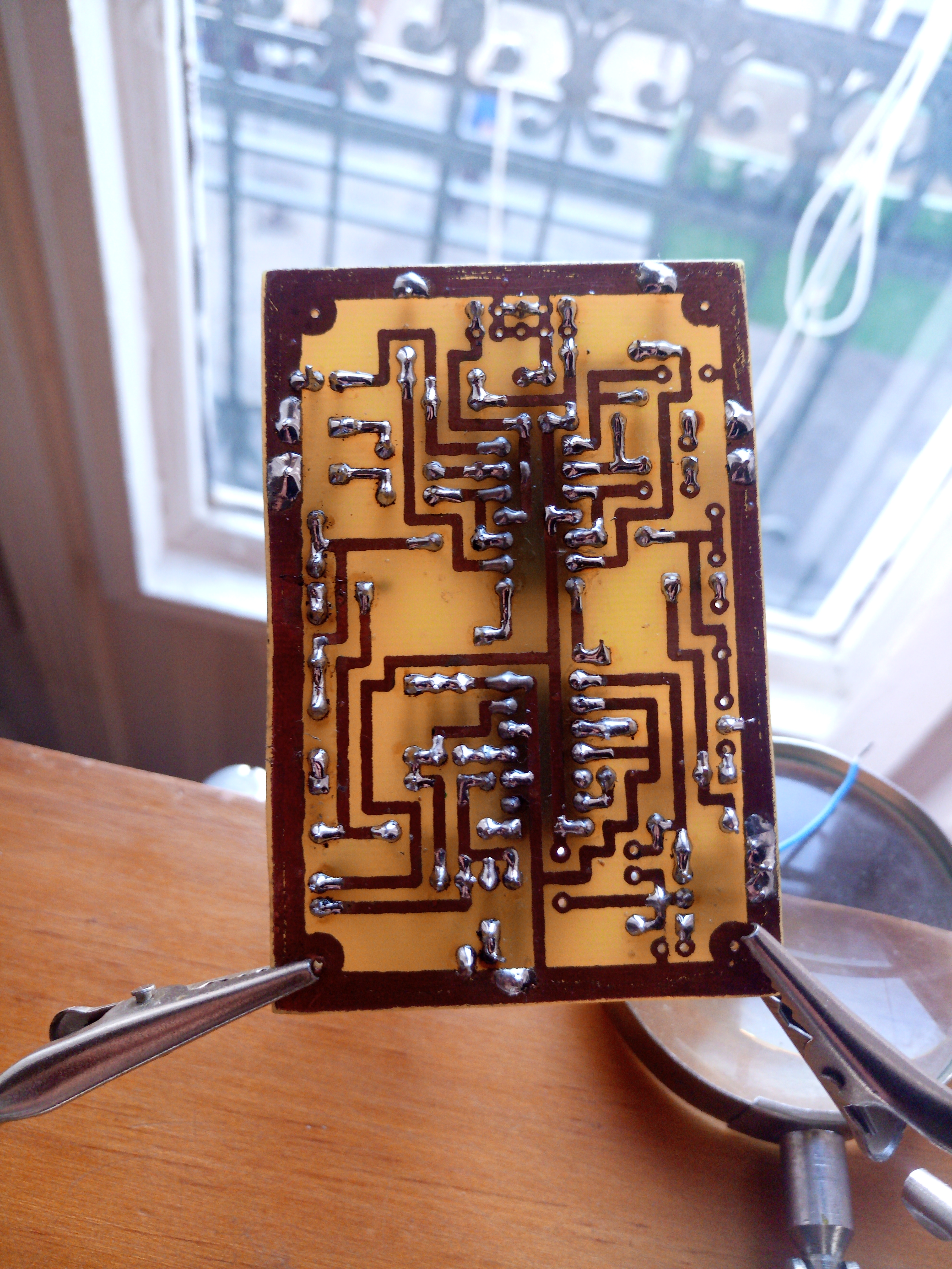

Alfredo
Posts: 52
Location: Spain
PostPosted: Mon May 13, 2019 1:17 pm    Post subject: Voltages ok Reply with quote  Mark this post and the followings unread
Hello, Voltages OK.
I will clean the board with alcohol.
Some pics Both sides, think soldering is correct:
Thanks a lot.
 Filesize:  5.81 MB
 Viewed:  362 Time(s)
 Filesize:  5.07 MB
 Viewed:  377 Time(s)
isak
Posts: 847
Location: Israel
Audio files: 18
PostPosted: Mon May 13, 2019 1:31 pm    Post subject: Reply with quote  Mark this post and the followings unread
D6 is not correct, you solder it backwards.
beside that the board look ok, just needs cleaning.
one more thing please, i may think i did the pots connection backward.
meaning when the A and R is in counter clock wise its actually open.
after fixing D6 orientation please try to turn the A fully open, that will mean its actually close, leave the R as is.
please report back Smile
Oucht! Yeah isak My big mistake! Rolling Eyes
I put the diode correctly and works smoothly, not the faster envelope on heart but cool! Now I need to get the log pots.
