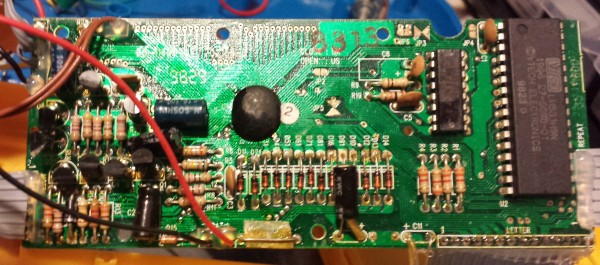

Good evening everyone,
New to the forums. Have been reading for a few months now and wanting to start posting.
I recently modified a VTech Alphabet Desk and I am having a lot of fun developing various sounds on the device. However, I cannot locate the timer resistor or crystal oscillator that is controlling the timer for the circuit.
I have pitch bent other devices, but this one seems elusive. Some of the glitches are very fast and jumbled, and a pitch/timer pot would help hear some of the complex sounds being emitted by the device.
I have also tried the starved battery pot and it works to a point, but the circuit usually gets upset and crashes, shutting down.
Attached are some pictures of the board. Any help or advice would be greatly appreciated.

hmm I've bend a vtech thing before and I don't think I found anything to control the pitch either (else I would probably have added some pitch conrol).
I know there are PIC's that can run on an internal oscillator without any external components,. so it might be that it works that way.

Check here for pitch mod:
http://www.sailormouth.org/binst.html

There's a lot of different models of Alphabet Desk, and the SailorMouth one is for the white front, blue base version. The white front/red base is more awkward as it seems the clock osc is built into one of the chips. The one in the original question is the yellow front/blue base model, which I have around here but haven't had a chance to open up yet. I would suspect R9 and R19 by the two chips would be the place to look, as it's a similar (but different) board to the Letter Fun PC, but not sure it'll definitely work, as I didn't add a pitch mod to the Letter Fun at the time either!
