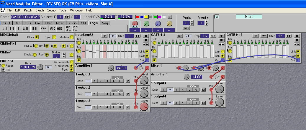

Cv Sequencer output from the modular g1

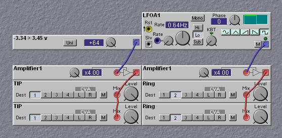

PostPosted: Sat Feb 01, 2014 12:17 pm    Post subject: Reply with quote  Mark this post and the followings unread
Agreed - this is the only viable route i found - it doesn't work beyond sending to the same out more than twice though
Big usefulness improvement though

What about the polarity of the G1 headphone output? The G2 output is inverted (I don’t have my G1 Rack or Micro in the studio, so I can’t check any of this myself).
Thanks for the picture – good patching example and info about which output bus is connected to the tip and ring for the headphone plug.
